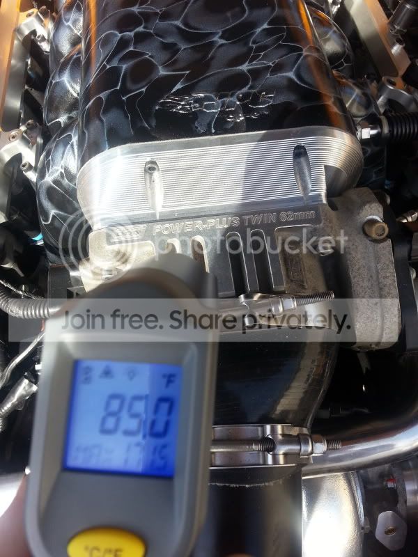

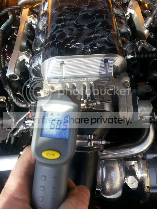

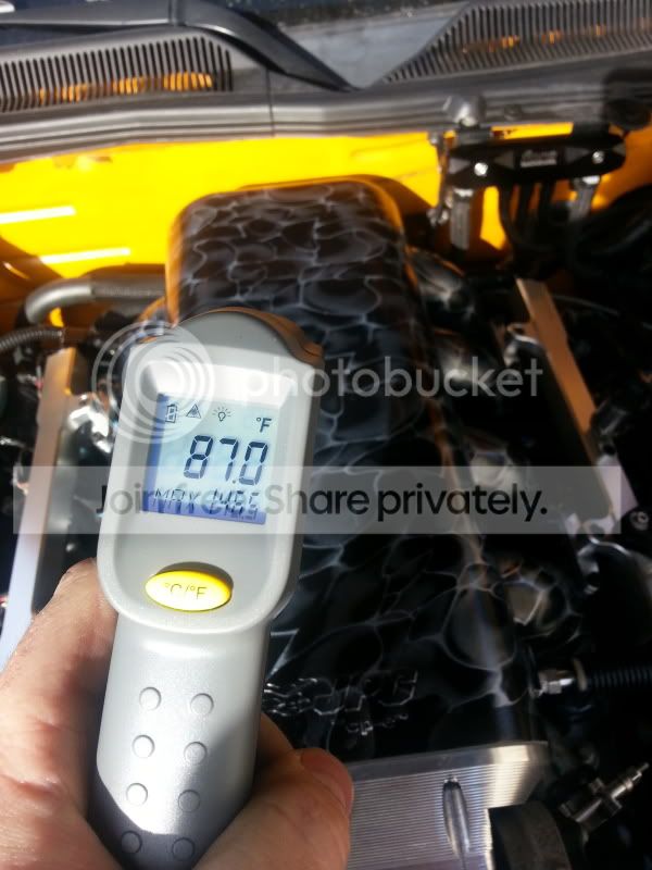

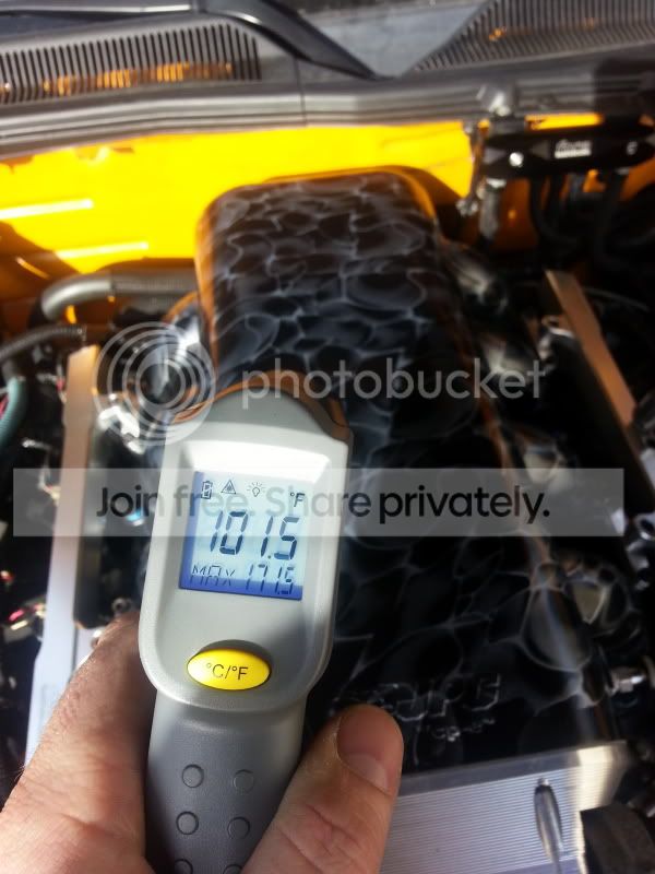

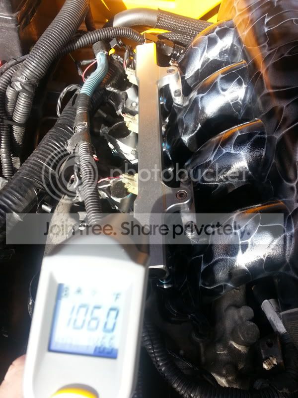

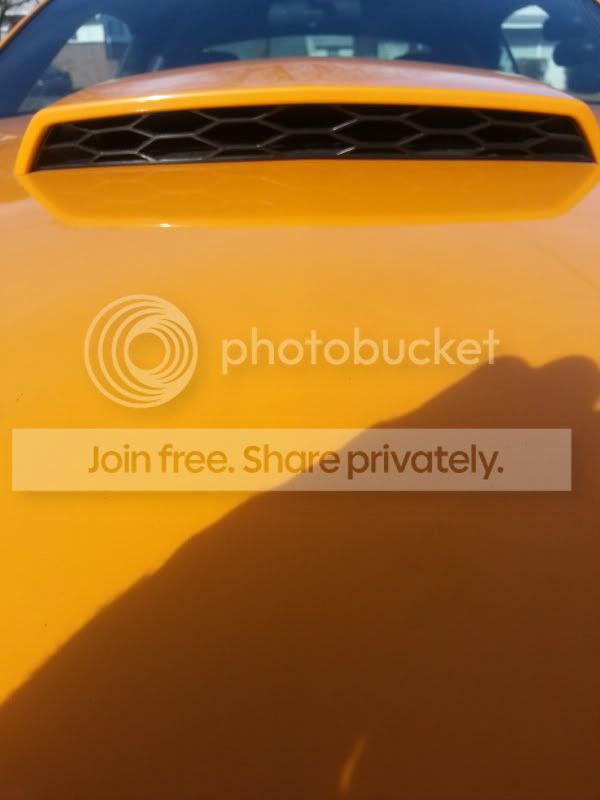

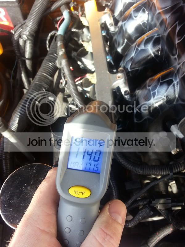

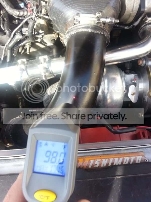

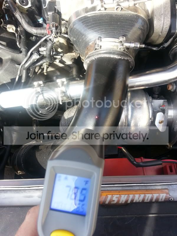

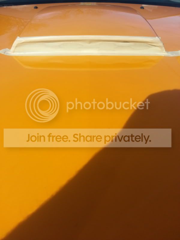

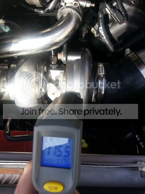

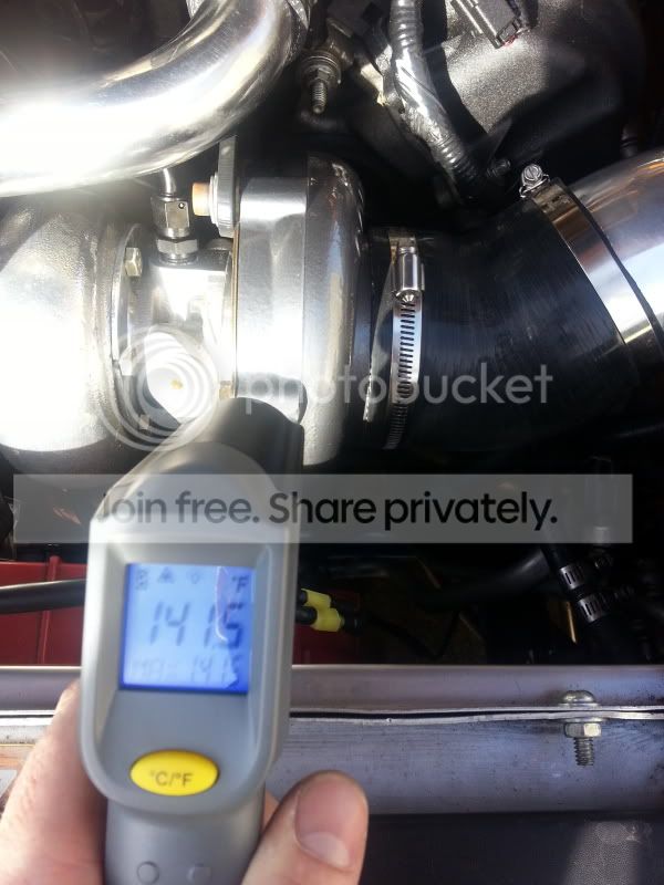

Just remembered I did this awhile back here is some numerical data vice touching things with your hand etc.
I tested hood scoop open vice taped closed.
Got a nice thermal temp gun for christmas so finally got around do doing some testing of the open hood scoop mod I did years back.
To see info on this mod and how I and others have done it look here:
http://www.s197forum.com/forum/showthread.php?t=22443&highlight=scoop
(on mine I left the stock honeycomb in place and opened up the back of it)
I will do another run this summer on a hot day as well and add it to the thread later on.
Intial conditions for todays "wintertime" test. 45 degrees outside. Let the car warm up to 190 degrees before testing (where my high speed fan kicks on). I then drove for 15 minutes on the same route before each test which involved a mix of city and highway driving. Then I came back home immediately opened the hood and took the temps with engine still running.
Run 1 - Hood scoop taped shut.
Turbo compressor cover
Intake pipe
Thottlebody
Intake manifold
Fuel rail
Run 2 - Hood scoop open.
Intake pipe
Thottlebody
Intake manifod
Fuel rail
So results for "wintertime" 45 degree day test are:
-----------------------------Closed Scoop-------Open Scoop---------Difference-----
Turbo compressor cover------ 141.5 -------------- 115.5 ------------- -26.0
Intake pipe------------------- 98.0 --------------- 78.5 ------------- -19.5
Throttlebody----------------- 85.0 --------------- 68.5 -------------- -16.5
Intake manifold--------------- 101.5 -------------- 87.0 ------------- -14.5
Fuel rail---------------------- 114.0 -------------- 106.0 ------------- -8.0
So big difference! And overall average underhood temps were 13 degrees cooler with the scoop open. Not bad for a free mod. ;)

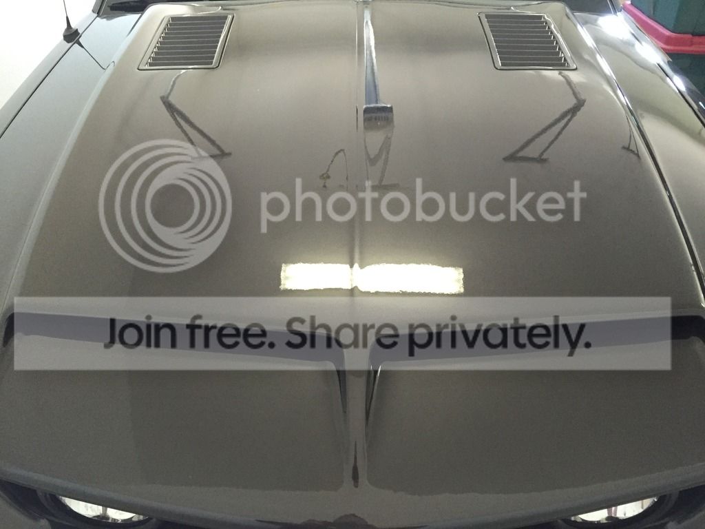

This is the hood I'm running. Best of both world in my opinion when I got it.
Yet I still saw 224 engine temps with it.
