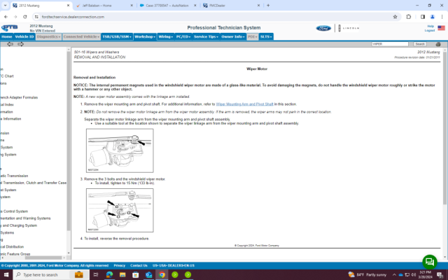

I know how to remove and replace a wiper motor. Thank you for the diagram though. I've never seen a wiper motor for this car that comes with the linkage attached to it, it's just a motor and you bolt it up to the existing linkage.
I have a new motor being delivered today, hopefully I just got a bad one out of the box. Also going to de-pin the connector and check all of the terminals on the plug for corrosion.
Not doubting you. Did you read Note # 2?
Here is a pic of a OEM Ford S197 wiper motor. It comes with the linkage arm attached.
I did.
I clocked my armature the same was it was when I removed the existing motor. Like I said, it works perfect with no wiper arm attached, but for some reason, the drag/resistance of the wiper arm causes it to freak out. It's not an alignment issue.
