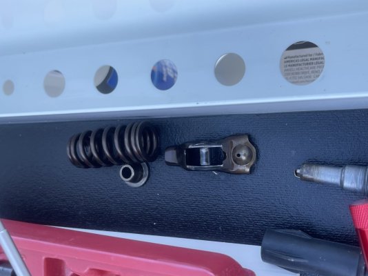

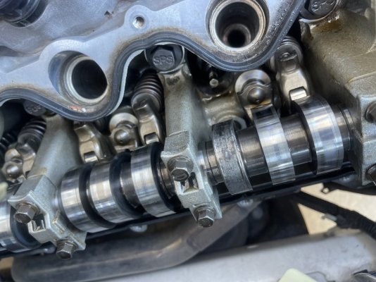

I recently bought a 06 Mustang GT and stupid me didn’t compression check the engine because the compression tester we rented won’t fit down far enough to screw into the spark plug hole so bought it anyways. Well after about 50 miles I got a check engine light and thought for sure it was just a vacuum leak or something but could never find one. Finally was able to compression check it and found cylinder 1 had no compression. Weird thing is I couldn’t really hear it at idle but I’d did kinda feel a little low on power driving it but never really hear a miss. Pulled the valve cover and the retainer and spring were just sitting under the cover not in their right place. Took my bore scope and looked into the cylinder and you can see the must be bent and just sitting there at the top of the cylinder. Also my Ford racing hot cam is scared on one of the lobe’s. So now I’m gotta replace my engine.

I don't think you need to go as far as replacing the whole engine. Even if you get a used replacement engine, you'd be playing Russian roulette with it anyway.
I suggest you pull the passenger side cylinder head, replace the bent intake valve, replace the cams, replace all 24 cam followers/lash adjusters, and you'd be good to go again. The cam followers are known to go bad on these engines at some point and it looks like one of yours seized altogether. You were actually lucky not to have catastrophic engine damage. You may find the two valve keepers sitting in the bottom of the oil pan.
It's up to you if you want to add a timing job and new oil pump to the job list but judging by how clean the engine is inside, someone has clearly maintained it well.

The Hot Rod cams are considered to be NSR so no springs or phaser limiters/lockouts are required.
I reckon the mode of failure was a seized no.1 intake rocker. It's a known Achilles heel on these engines and it usually begins as a ticking sound. Left unattended for months, the needle bearings will eventually seize and the rocker will eat into the cam lobe. At some point the rocker will break and a flying remnant could take out the valve keepers and the retainer. The OP was very lucky the valve didn't drop into the cylinder otherwise it would have been goodbye engine.
An engine overrev from a money shift would have bent both intake valves in the same cylinder so that seems unlikely.
The OP should drop the oil pan in addition to performing all the work I suggested earlier (including a timing job and new oil pump), as I suspect the valve keepers are probably sitting either in there or inside the oil pump pickup screen. I reckon that for not more than three grand, he could rebuild his engine and it should be reliable enough to last another 100k miles. One other thing I'd suggest while the oil pan is off is to inspect the rod bearings. Since this is a track car, it might be a good idea to upgrade to a road race oil pan to prevent oil starvation during hard cornering.
