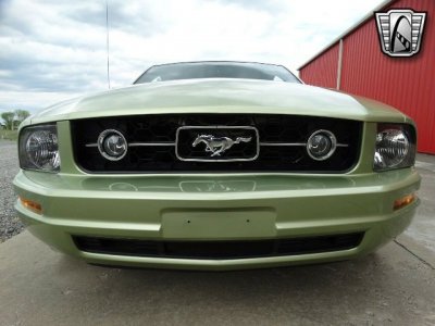

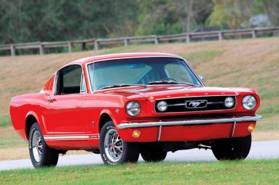

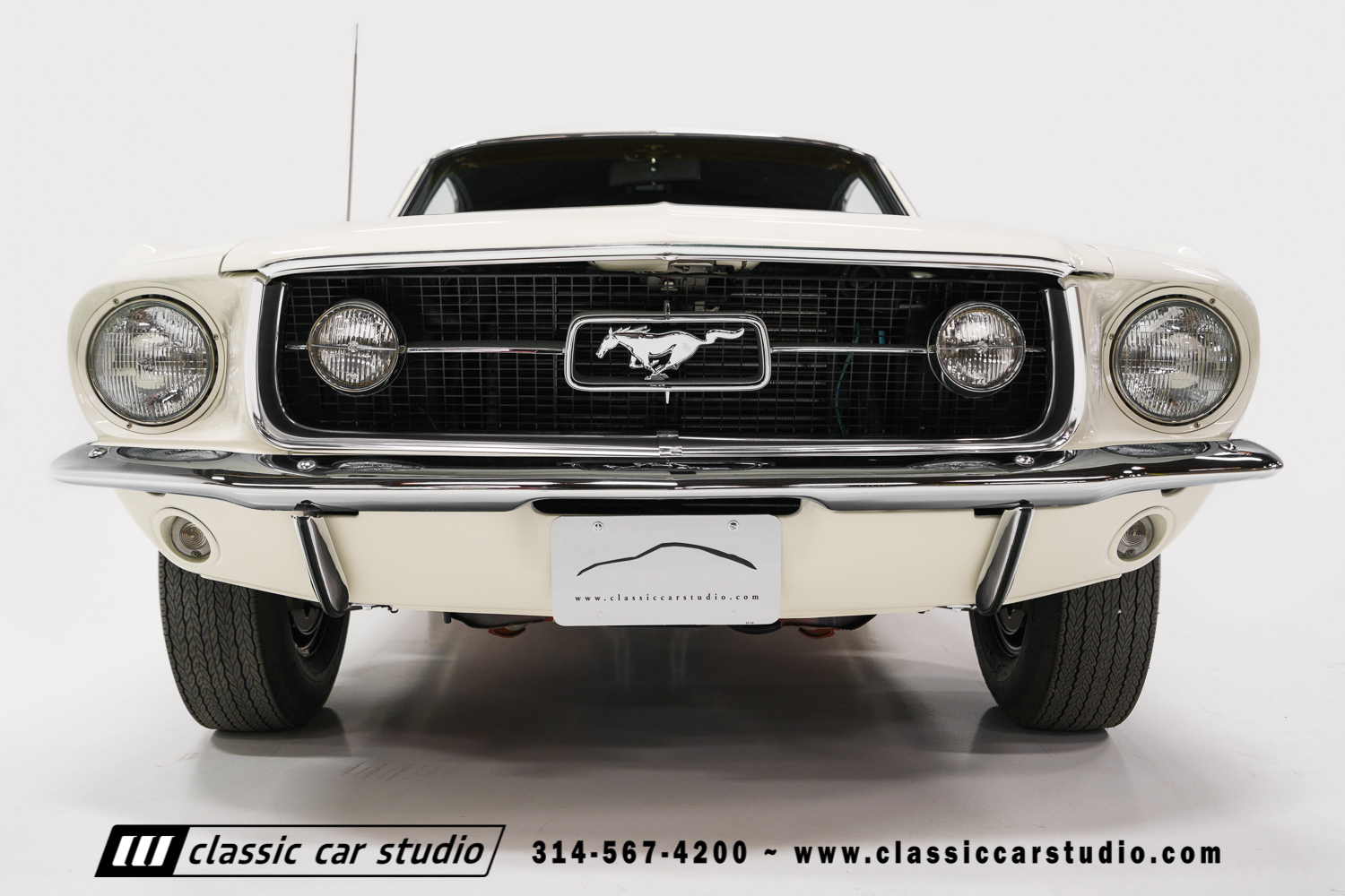

That grille reminds me of my first Stang a 1967 GT in Wimbledon White
Juice
Aug 24, 2017
4,629
1,908
IMO the smaller v6 foglamps look the best of all the factory grilles. Like the 67 posted. I dont care for the oversized "rally car" style ones in the GTs. I would have to do something if I had a GT. lol

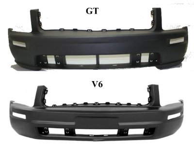

I emailed LMR and asked why the GT 'Bullitt' grille wouldn't fit...Here's the reply -
The V6 grilles and bumper grill sections are smaller than the GT models and also have different mounting tab orientations. Therefore we list the LRS-8200Y grille specifically for the GT model vehicles and will not fit the V6 or GT500 bumpers. Installing a GT front bumper such as item LRS-17957E would be a direct install for this grille.
So the 'Bullitt' grille will work if you also replace the front bumper cover...and paint it to match car... :(
I blew up and printed out pics of the grille and the tabs are in the wrong places...
richie9mt
Sep 26, 2021
130
19
Western NY State
I compared pics of GT and V6 bumper covers...GT also uses GT-specific lower grille as well... :(
Mounting tabs for both upper & lower are different for GT and V6...tab-comparison.jpg

There are also a couple of 'extensions' needed to change to the GT bumper...2 small pieces that have to be riveted to the inside of the outside corners of the bumper cover. Personally, I prefer the clean lines of the V6 bumper cover. The Bullitt grille is my favorite of the OEM ones, but It's not worth a bumper change, IMO.

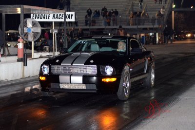

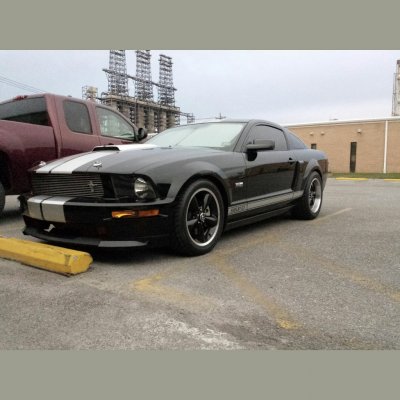

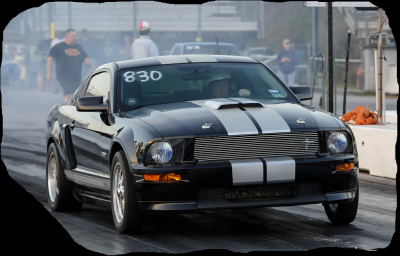

Hi Richie,
First of all I have to say I agree that the clean lines on the front of our S197's just looks racier (Shelby-esque) and much classier without the big fog light rally car look. I have the Shelby grills and they are good quality aluminum and give the car a mystique especially with the small pony grill emblem and no big horse in the middle like most every other Mustang. Not that I am worried about the horse emblem which is after all quintessential Mustang. It is the big fog lights that look ugly in my view. With my setup, I have had Mustang owners and other car aficionado's approach the car closer because they weren't quite sure what it was until they saw the small pony emblem and then you see them nod their head and up and down and silently mouth, "Oh oh, it's a Mustang!" Those interactions make my day :)
Now, as y'all know I'm sure, the S197 concept car was first debuted at the North American International Auto show in 2003. Wiki states, "the fifth generation Mustang drew inspiration from the first-generation 1964–1970 Mustangs." and also noted that it "has been described as retro-futurism".
In regard to retro part of that statement, I believe the S197 is the only modern Mustang you could sit next to a '67 fastback and the lineage is strikingly clear. I have added the chrome front bumper trim (its only plastic though)and the retro headlight surrounds both of which drag this car back in time like no other.

Now I understand your pain in not being able to fit a custom bullet grill due to the V6 dimensions but if that's what it is then you can still come up with a winner. With all due respect, I think you are missing something really cool here. The 67 grill is what you have on your car. Wow!! The smaller grill lights make it classy and not rally like, and if you applied the chrome bumper and the retro lights, just think how cool that would be! Maybe some stripes and a grill on the rear side windows and I have also put chrome surrounds on the rear lights, again to garner that 67 look. I didn't realise your grill even existed on the S197, so I'm kind of blown away by that. If you made these mods and kept the grill you would be channeling the retro-futuristic look, like a Boss!!!

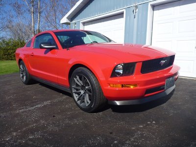

Thanks! The wheels are Rays/Gram Lights 57XR, 18 X 9.5. I don't recall the offset though. They're fairly lightweight, @ ~19lbs. Bought them at an import shop.

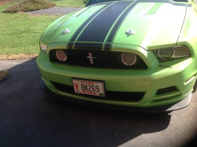

Many options, why wouldn’t just remove fog or driving lights along with horse. That does sort of ruin front end. Go for look something as this (old photo)?
