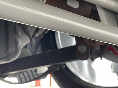

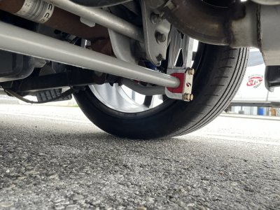

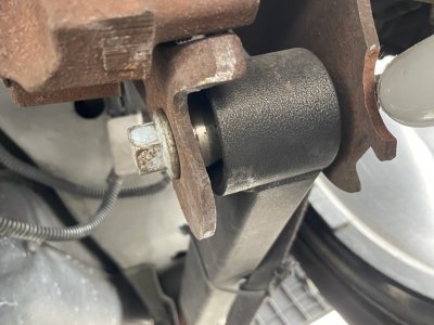

28091D06-A0BF-453C-A112-08738910E67F.jpeg C5F211D6-90EE-4527-9DEE-4BBDF49210A3.jpeg 80153E41-0F04-4709-A9FE-20F64B028FF6.jpeg Was thinking about the BMR relocation brackets for my GT. My lcas are the boxed BMRs and with all my suspension mods they are now slightly higher towards the rear wheels. I don’t have wheel hop or traction issues and the car handles and launches really well. That being said, just don’t want to leave anything “off” as far as traction and suspension. As you can see in the pics , the shop I take my car to had to grind a little bit of the oem bracket for the Steeda rear sway to fit on the passenger side. I don’t know if it’s worth the hassle of modifying the new relocation brackets, or if they’ll even fit with the rear sway bar. Are relocation brackets really necessary if it’s just a weekend street car with maybe some future track runs here and there? Thanks for any advice / info

Had a chance to drive this morning and really push the car. Beautiful Florida Sunday, mid 60’s , sunny and early, so no traffic. Cold enough for some nice cool dense air and warm enough to get my tires sticking. Did some big on ramps , q shaped tighter on ramps , couple of launches and some hard pulls shifting at 7100 RPMs. Car handled everything great , only wheel play ( except for 2 launches) was shifted from fourth wound out to fifth and wheels slightly jerked and chirped. I don’t plan on adding more HP as I’m pretty much FBO except for an intake which I’m leaving stock , so guess I’ll just not worry about it too much. Car definitely performs up to and probably past my driving skills so…. Was just interested in hearing other’s opinions on this as I’m way more interested in traction ( corner carving) rather than straight line speed. Keeping the car on a square setup is also is my goal , so no drag setup for traction for it.

YES, whenever you have lowered the rear ride height on the S197 chassis you REALLY SHOULD install the rear lower control arm Relocation Brackets. Whiteline (shown), Maximum Motorsports, BMR - it almost doesn't matter who's kit you use, just DO IT.
This LCA relocation bracket change "fixes" some rear geometry issues that DO occur when you lower the rear ride height. Now many folks over-lower the rear, and without a shorter rear shock and bump stop changes this causes a lot of problems... but that's a story for another day.
The sphericals in the LCAs and the billet swaybar bracket are making my eye twitch, but I'm not gonna hound the OP too much for that.

the lcas were already on the car when i bought it. it was originally lowered on H&R springs and OEM shocks and struts and was way to low and rode pretty bad. i added all the steeda suspension (yes the billet sway bar brackets) to raise the car back up and to handle better. i just dont know what to do about the sway bar location where the LCAs OEM bracket had to be modified for the sway bar to fit. looks like any relocation brackets would be a problem fitting them on at that particular spot. this is the last piece of my suspension that i have to do.

Oh yes. I tried the lowest hole on the BMR brackets. The result was too much anti squat for my set up. Lifted the rear of the car and spun the tires. Medium/heavy breaking resulted in break hop. Holy shit, never felt that before. They work great in the center hole. Very stable on slicks.
I have the BMR's as well and I tried the bottom hole and the video showed my rear spoiler coming up what appeared to be almost 3". Couldn't do better than a 1.84 60' with that setup and it bogged on most runs.
I'm considering cutting off the bottom hole as I can't legally run my 15" wheels with them as the Motor Vehicles Act for BC does not allow any part of the car to sit lower than the bottom of the wheel rim. I am legal on 20" wheels, right on the cusp with an 18" wheel, and definitely illegal with my 15's.

I have the Ford Performance LCA brackets and it's a tight fit with the rear sway bar. The Whiteline rear sway bar would provide much more clearance, but the Whiteline is much stiffer than my current sway bar. It would mean more testing to figure out the right suspension setting and maybe even changing the front sway bar.
