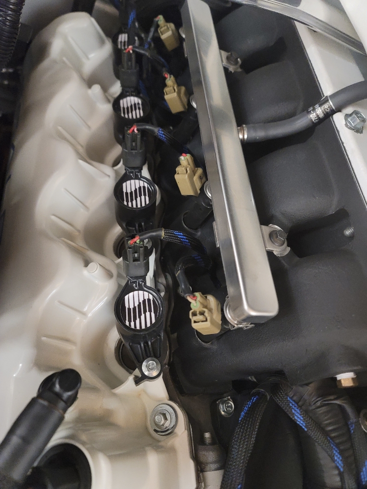

I did a complete wire tuck, so I don't need those posts on the valve covers. I re-built my wiring harness so that it sits down in the engine block valley area and the wires extend out from in between the intake runners to the injectors and coils.

I did the same thing. The only pic I have is from back when the car was still NA. This required drilling a hole in the webbing between the runners of the stock manifold.
