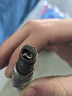

2 plugs out so far using impact. Neither have broke but the porcelain shattered in both

Cool headed to parts store now. Got all 4 plugs on driver's side. None broke but 3 have shattered and drop porcelain pieces in cylinder

Get yourself one of those long/thin blow gun extensions at the auto parts store/Harbor freight. Push it down into the cylinder and blow them out several times. Suggestion when you're removing plugs with the impact try to tease them out vice hammering 'em out. The porcelain shouldn't be shattering like that. Regardless, you want to get all of the porcelain out of there. If you have a bore scope worth looking down in each cylinder to ensure nothing remains.

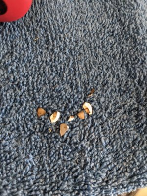

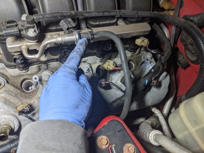

So we made it to lunch and eating a sandwich. We have gotten all the plugs out and all but 1 had shattered porcelain.we have spent the past hour slowly rotating the crank, blowing out each cylinder, vacuuming each cylinder and repeating multiple times. You can see some of the pieces in this pic. I think we have it all cleaned out but we we will repeat the process before we install the new plugs just to be safe. I'm so paranoid and nervous right now. All in all it's going good. Valve covers are up next

Go rent a bore scope or visit Harbor Freight. Think they're less than $100?
