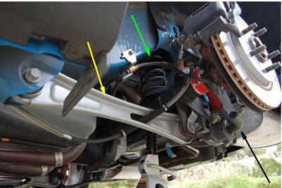

Is this what your control arms looked like?

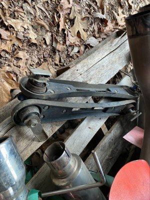

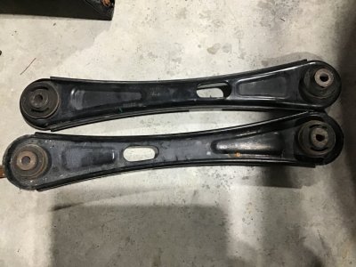

No. They only have one hole in them and the edges are double folded. I’ll get a picture of the two and post them

Those are the stock LCA's then. The GT500 arms only came with the performance pack and the GT500 of course. They are a nice upgrade when you are ready though.
Edit: After looking at the pics of your 07 LCA's they appear to be the GT500 ones.
