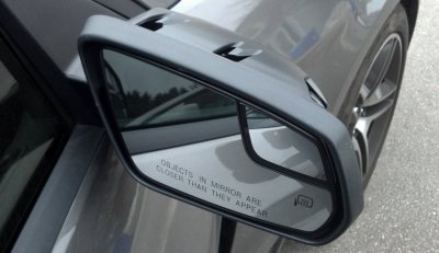

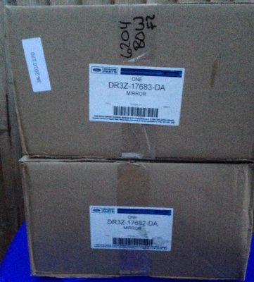

I have a base model '13 GT and I put in the pony-logo / heated mirrors.
Plug and play on '13-'14 Mustangs.
You'll need to transfer the painted caps from the existing mirrors:
