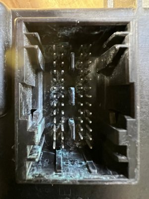

I was thinking I had a broken wire somewhere so I was going to try to determine if it was before or after the smart junction box. After removal of the SJB I found this:
The broken connector is #39 on C2280b. This corresponds with "horn switch, control". I am 99.9% sure that this is my problem. My questions: is this something that can be fixed? If so, any ideas who to take it/send it to? I really don't want to buy a new SJB just to fix the horn if I don't have to. If it does come to a new SJB, will the installation be plug and play? Or will I have to have Ford reprogram?

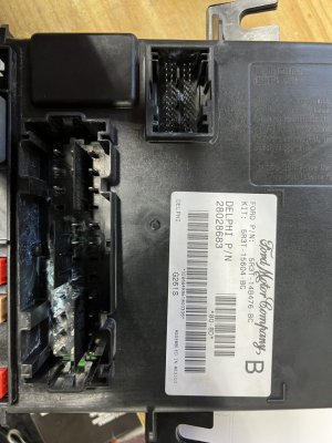

For reference, the plug with the broken pin is the one to the left of the fomoco sticker
