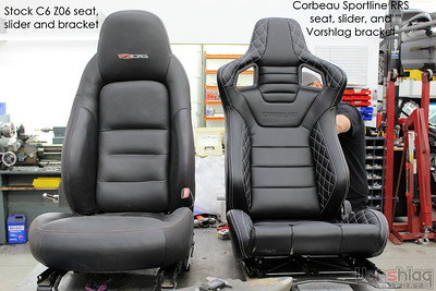

We just finished a new seat bracket design for this "bottom mount" reclining seat on my wife's C6, above. This is a Corbeau RRS seat, which is the same on the torso as the RRB, but is easier to get into (yet has less leg support as the RRB).
The C6 comes with absolute GARBAGE seats, which make the Mustangs seats look pretty good in comparison. On track it is like sitting on a park bench! We had to re-think our entire seat mounting bracket designs to work with the very different spacing of the bottom mount Corbeaus...
Above left is one of our many seat bracket bases for side mounted fixed back seats. The width for the side brackets or sliders is VERY different than the bottom mount sliders used on reclining seats like Corbeau. The sliders are also much more substantial on the Corbeaus, more like the OEM sliders - which are often part of the seat mounting structure.
Instead of re-designing our side mount style seat base brackets, we started over - and mimicked the OEM seat bracket/slider combos. We needed to add the tilt into the brackets, like the OEMs, so the seat sliders forward it also goes UP. On a side mount style seat we can just pick different holes in the side brackets to get the tilt right. Lots of other changes were needed, so it is a whole new seat bracket design.

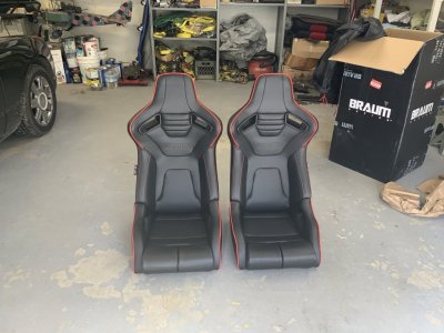

IMO,Braum makes the best looking seats. How are they on track?
I am 5’11 and 245. When I wedge my ass down into that seat I don’t move around at all. There is shoulder room but my torso and hips are supported. The seat is even comfortable wearing a helmet.
