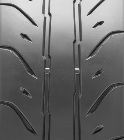

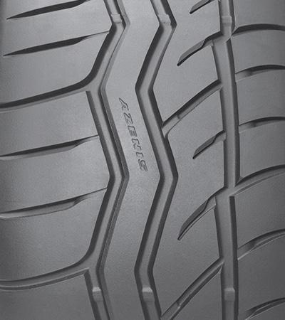

Get one of these and don’t look back!
Anyone who says Michelin SS’s are good for auto x, would love these Falkens.
The Michelins are expensive burnout tires. Just my opinion of course.
Top one is Falkin Azenis RT 615K+ and is very streetable and very good for auto x.
The bottom one is the Falken Azenis RT 660 and is the best auto x tire out there, hands down that is a streetable tire.

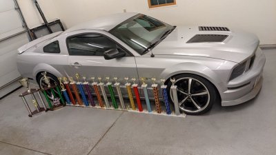

Here's a pic of the hardware I've collected in the past 3 summers of high speed autox, on 315/335 A7's. A few guys do show up on NT01's and they are never competitive.
