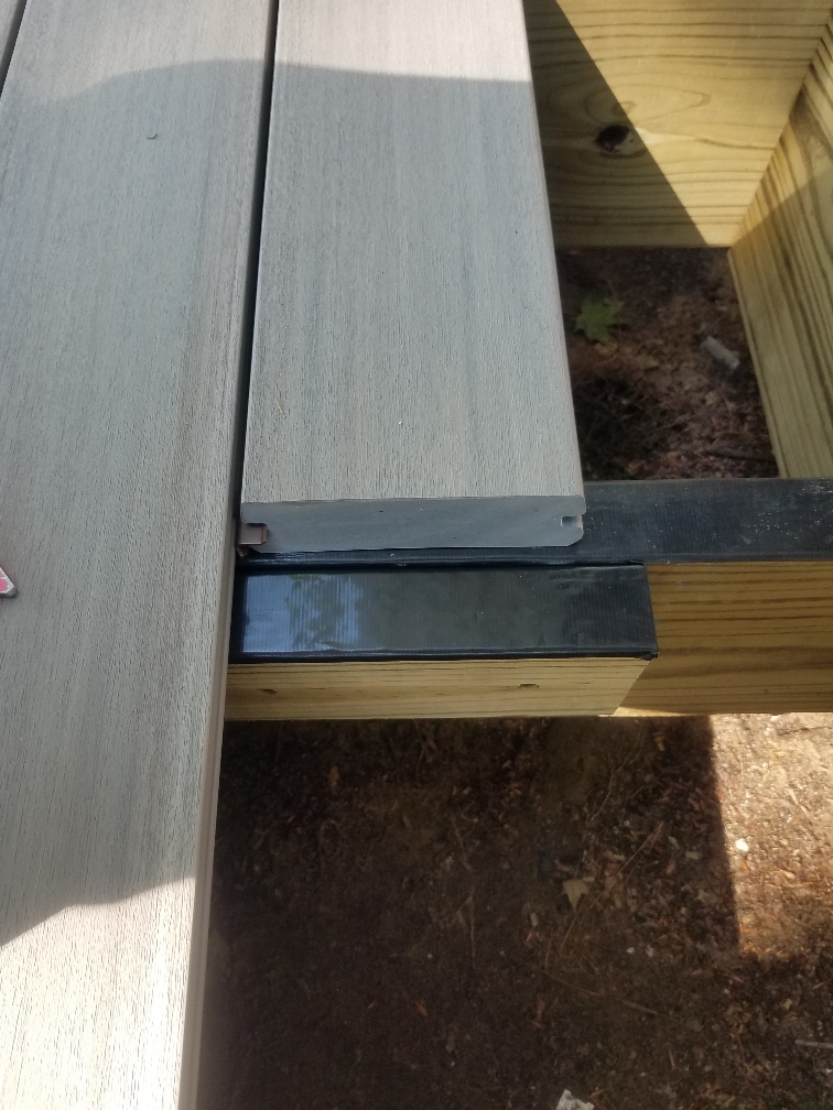

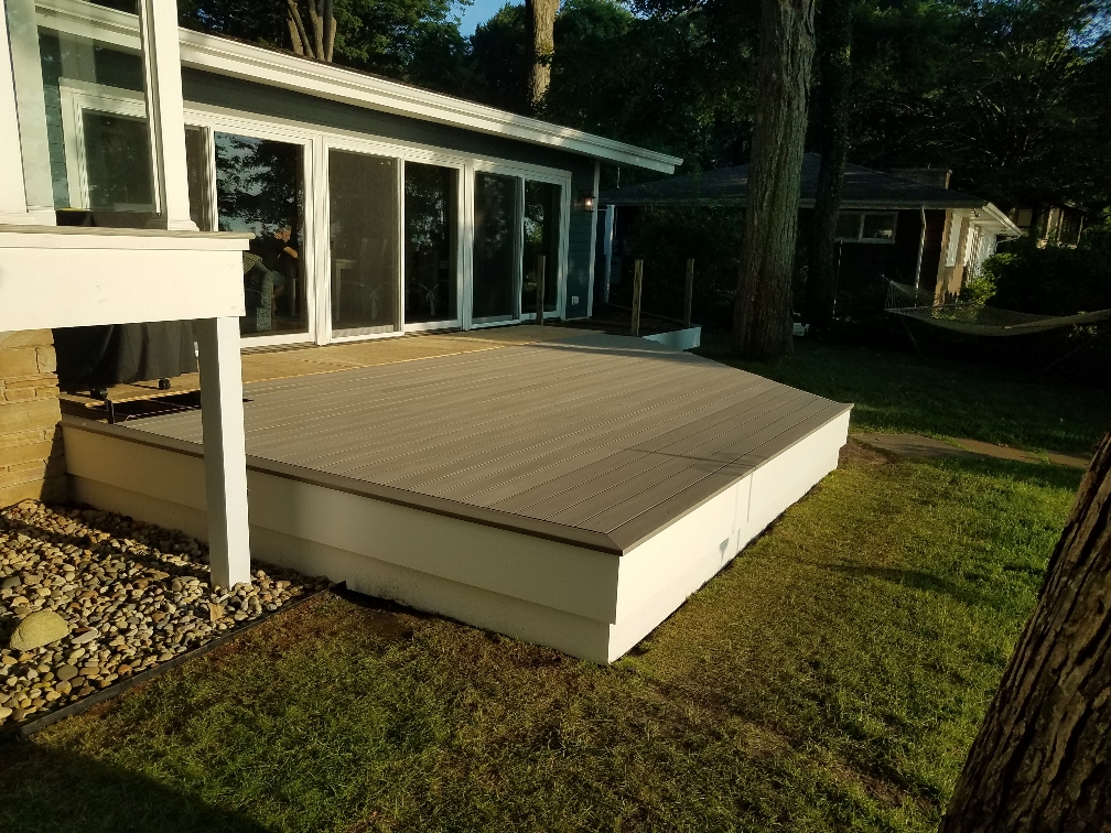

I'm having some issues with some of the board gaps opening up to the point where you can stick a finger in-between.
I used some Trex hidden fasteners, 2 different kinds, one T-shaped plastic retainer and a metal bracket. Both supposed to leave the perfect gap behind. Both going into biscuit cuts that I made into the sides of the boards (using a biscuit cut machine, lent to me by my bro-in-law). I want to pull them and use different hardware. I love the look of hidden fasteners, not face-screwed.
I used a heavy duty ratcheting strap when I installed the boards, to pull them tight. Gaps were great when I was done. Then within a few days they started changing. WTF??
Not sure exactly why it's doing that but I have a good idea what maybe causing it. Plastic clips if not screwed at the correct angle will allow excessive movement. The boards should have been installed as tight as possible when doing so. With a deck board tweaker. With out looking hard to say. Here's a Concealoc from azek I am installing right now. They actually bite very well if the screw is placed correctly.
Thanks, that's Trex though, right?
I used the Trex fasteners with the PT boards, cuz that's what my brother-in-law left for me to use, same fasteners he used in his deck a few years ago. His deck is doing the same thing as mine.
I still don't have railing on it so I might still pull the boards and reset them using all metal fasteners. Still trying to avoid face-screwing the boards since the clean look is so nice.

No this is a Azek coastline decking. The plastic hidden fasteners suck! These clips could be used on your deck but the camo tool and screws may be a better option now that you have biscuit joints/slots. I have another clip that may work with your current slots. I'll take a pic tonight when I get home. I think I have a whole box of them, they're specific to wood decking with biscuits.
This isn't my usual decks. I do a lot of ipe decking when we do it. If we do plastic, I prefer Azek products but this batch has been a bitch to deal with.

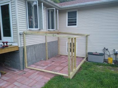

Started building a catio against the sunroom. It will eventually be screened in and with a while bunch of shelves/sitting areas and other things in there for the 2 fur babies to enjoy, outside. Also planning on installing a pet door into one of the window screens above it, and tying in an access to the catio through its roof, so they can go outside almost anytime they want.
very cool, can't wait to see the finished product

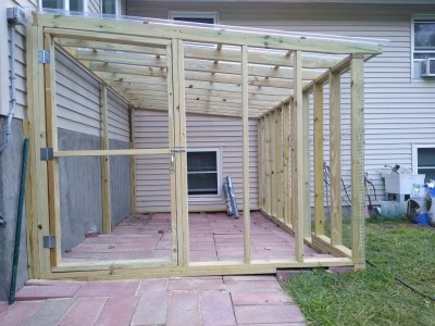

Made more progress on the catio.
I have the door wall left to screen, then the interior shelves/sitting areas, toys, and whatever else we'll cram in there

Cat jail. :(
Yeah. Mixed feelings. Wish I didn't follow advice going with 16" on-center, I was gonna do 24" (probably closer to 26" so as to have even spacing across all studs, the bro-in-law recommended 16".
Now the multitude of studs takes away a lot of the visibility and makes it feel more confined.
But they'll still be outside and they'll experience different air, smells, noises, and other things to check out in there.
Yeah builders love 16" on center but for what you are making an unnecessary expense and as you said too many studs.
Still looking good though
Thing is....cats...they don't care. LOL!! But I bet they will love being outside in it. You could probably remove every other stud and use the removed stud to double up the remaining stud and make it feel more open.
Being in NH and that being near flat roof, snow load could factor heavily. No pun intended.
