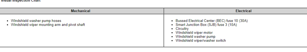

Pump stopped working a couple months ago. Just got around to replacing it and guess what. Still nothing. Is there a fuse I can check? Didn't have an extra set of hands and eyes to check to see if I'm getting power to the plug at the pump.

Why didn't you run power to the motor first to see if it was good? Yeah there is a fuse to check. Do you know if it is getting power??? And if it is have you checked the ground??? These are things to check before buying a new motor.

Don't know how you do it, but I have to have a helper to turn the wiper washer circuit on whilst I check the harness/plug with a multimeter. ;) I was at Advanced Auto buying some oil for the bikes and decided to chance it. It was the pump. The pins on the new pump were just a tad shorter and it wasn't making the connection at first.
