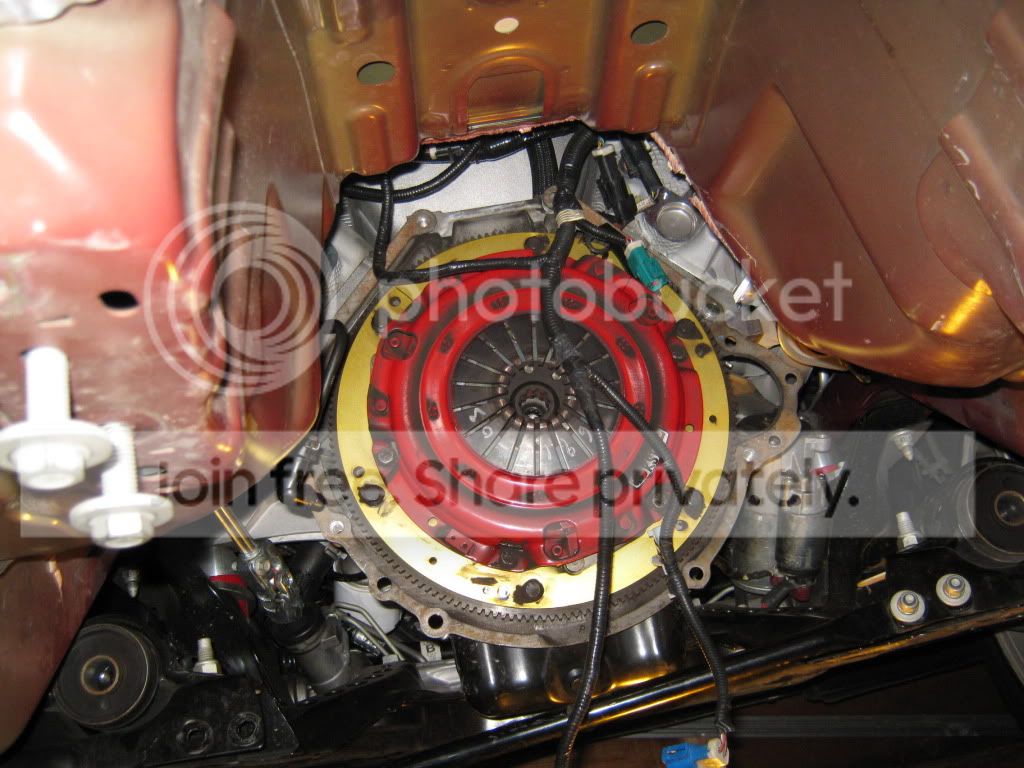

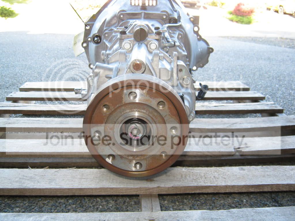

All done with my 6060 install. Thought I'd share a few pics of the process for those who may be considering doing this.
In the past I have had to lower the k member and motor and tilt the motor back to get the transmission to clear the tunnel. This time I tried clocking the transmission. It worked. Didn't have to lower or tilt.
Transmission out.

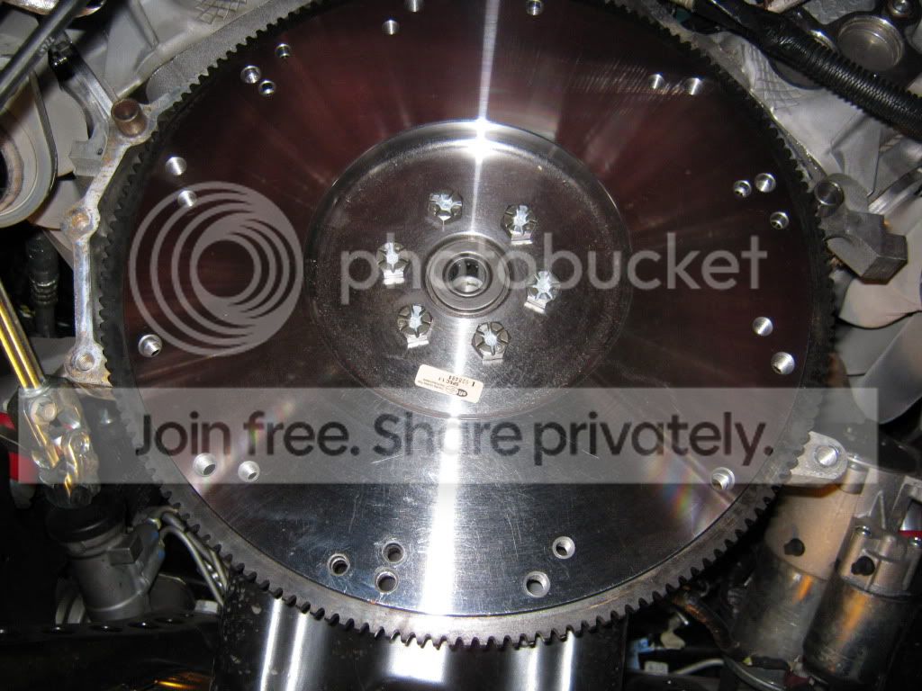

New McLeod flywheel. Beautiful.

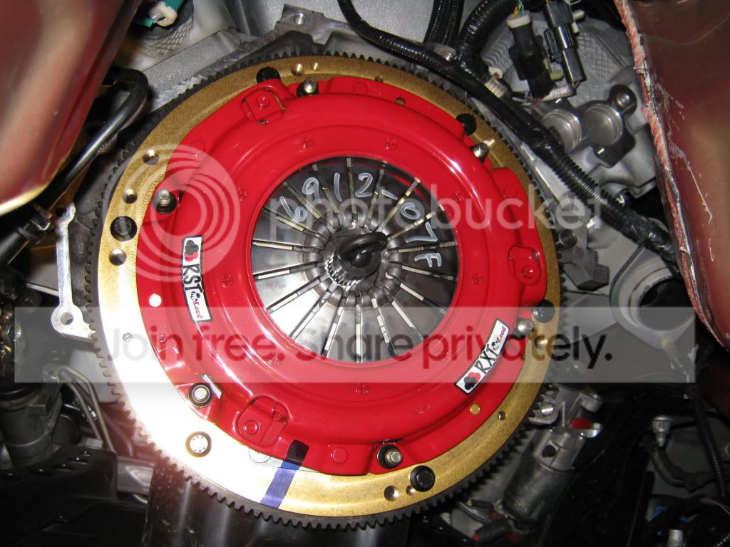

Floater ring and first clutch installed.
New RST installed. This was one of Tom's group buy purchases. Great price.

6060 on the pallet.
Went in without any motor lowering or tilting.
