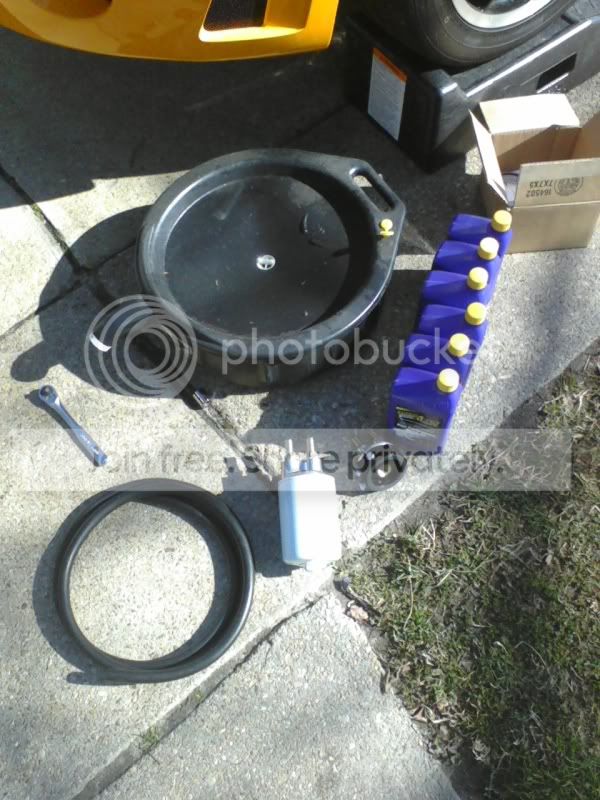

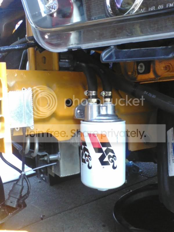

Perma cool kit from summ and glowshift sandwhich adaptor for oil/temp sensor and oil feed line for the turbo later on.
Here are some pics of the process.

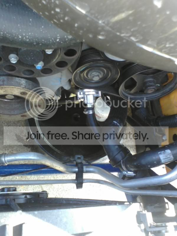

Didnt touch the stock sensor its still plugged in where it was. In the third pic down on the left u can see it.

Okay ran the car for a few minutes again still have the oil light. I felt the hoses and only one feels pressurized and i got a bunch of white foamy gunk on the underneath of the oil fill cap that wasnt there before, And the engine sounds like its making more noise than usual.
Im thinking maybe the sandwhich adaptor and oil relocation adaptor mounted together on the engine side is allowing the in and out side to mix. Not sure whats up.

You need to double check all your connections, make sure your inlets, and outlets aren't mixed, and possibly even the filter itself.
Something is not right, and it's going to get expensive quickly, if you keep running it.
Racingtheburg
Aug 30, 2008
2,827
I'm thinking its not returning oil. Check to make sure there are no caps on the return side. Blow through it with mouth to be sure nothing is in there.

sounds like water got in the system, the white foam is what happens when you introduce water to oil and compress it. Are you sure the pressure line is hooked up to the side fitting and the return one is coming out the center on the adapter

Yeah i agree i dont feel comfortbale running it anymore than i just did. I checked the lines and the engine adaptor is labled in and out and the filter adaptor is labeled in/out. I ran the in to the in and the out to the out. Is that right? Or do i need to go engine adaptor out to filter adaptor in, and filter adaptor out to engine adaptor in. Thats sounds right didnt think of this at the time lol, just was thinking okay in to in out to but thinking about now i might have it wrong.

Hey how should the hoses go?
Like this?
engine adaptor out to filter adaptor in, and filter adaptor out to engine adaptor in?
Like this?
YES.
You may have also damaged the internal element of the filter by trying to run oil through it backwards. Not to say how the anti-drainback valve would react to this reversal.

Thanks man you are a livesafer, knew something was wrong just didnt know what. Im going to go drain the oil swap the lines and inspect the oil filter.

The drain back valve should actually stop the oil from exiting the filter in that direction. Check the rubber flap that is under the perforated holes to be sure it isn't damaged as it probably was/or trying to hold back 90 psi of motor oil. If you didn't run it for more than a couple seconds you should be fine if there is any damage it should be evident at the cam caps as they are the last thing to recieve oil from the pump.
Good Luck and hope nothing was hurt
