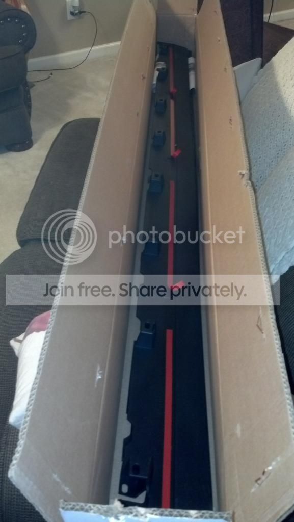

I bought a set of the Roush Side Splitters for the 10-12's and wanted to modify them to fit my car.....Not sure if anyone has made a thread about this before but this is my write up and how I am doing it.....
Here is the start and I will post up more pics of them as I get them installed and throught out the process......

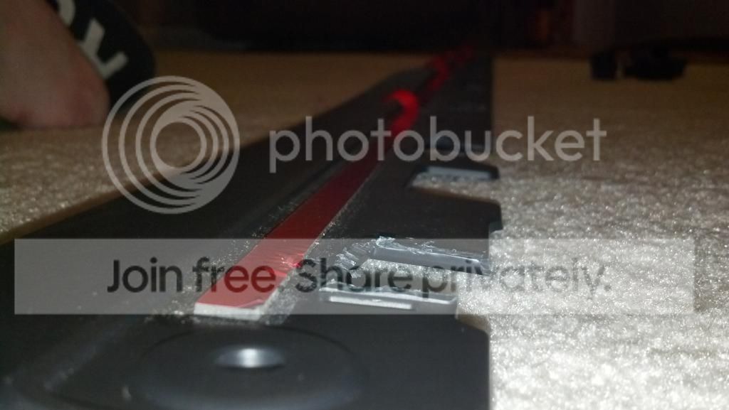

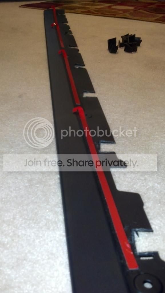

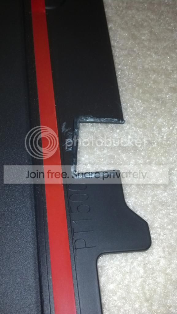

First you have to cut off all the tabs that are sticking up......Then grind them smooth......
I just finished one so here is after I cut off all the tabs.....but I have not grinded them smooth yet......more pics of that will come once I finish that....
