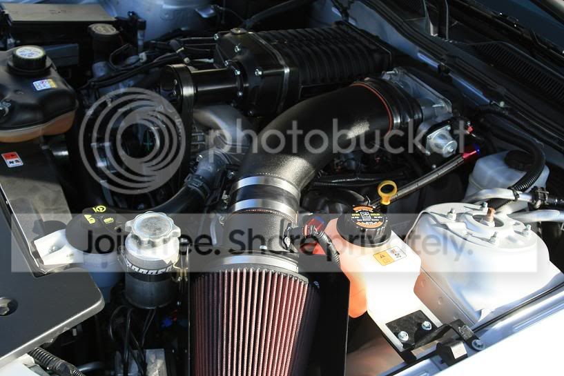

My set up is very similar to the above. I used the stock ends with some braided stainless, AN fittings and a Morosso can because Stef's was back ordered. I want to say the parts were around $180 but it has been a while.
I just made a bracket to bolt it to my whipple shroud as it was the easiest way to run it.
I empty the can when I change the oil and there is a fair amount in the can everytime.
Here are the best pics I can find.

Looks good thanks for the pics & info.
