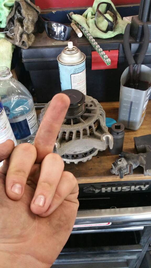

Replaced it today at work. Along with my fuel pump.

reman alt did nothing. scored a used take off 2010 unit from ebay for 60 bucks, saw an immediate jump in charging voltage - 14.4 now vs 13.3-13.6 before. also did a couple upgraded grounds, and power wire to underhood junciton box a while ago which seemed to do....not much.
