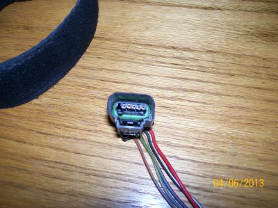

Thats the hardest part ,finding a pin thats the correct size for the PCM Plug

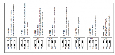

Then set the Raptor shift light to 8 cyl the switches are #1 on and #2 and #3 off

And a pic of the switches on the raptor, and a couple of pics of the donor plug I used for the pin
Need to set the raptor for 4PPR
