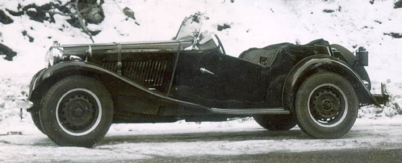

I started with the very economical UPS-wheel look in 1957 on my MG TD, and followed up with the same scheme on every sporty or racy-type car I've owned since then—until the Mustangs. I did have a set of the GT500 black-center, polished-lip wheels on the GT/CS convertible.
If you have black wheels, it's very simple: jack up corner, make a support for your paintbrush, spin the wheel and make the first silver pinstripe at the inner edge of where you want the rim silver to end, fill in the rest to the edge of the wheel, being careful to not paint the tire. Four of those and you are done. With the right combination of paint types on the wheel and edge, the edge can be wiped off with an appropriate solvent, so you can go back to black with little pain, or just change colors. If you really like it one way or another, you can do the rings and clear-coat them.
