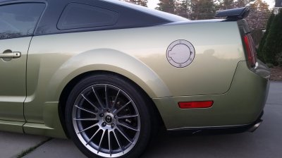

Fiona's got some new shoes!!! HRE FF15 wheels in 19x10 ET40 with Potenza RE-71R tires in 285/35/19. At 20.6 pounds per wheel, it's a significant unsprung weight reduction, and no spacers are needed to clear the Brembo 4P calipers.

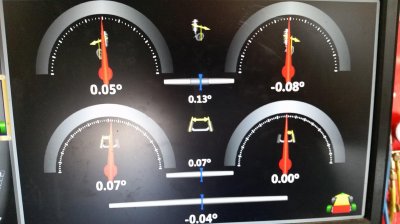

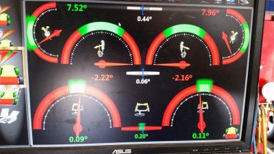

Along with the new shoes comes an alignment. Comments welcomed on the camber differences. Toe and caster are right where I wanted them.
While I was at it, I took the time to recenter the rear axle. Had to shift it to the passenger side about 1/8" to get it just right. Adjustable PHB made it pretty easy, but it's a bitch getting to the jam nut on the passenger side. I just wedged a pry bar against the jam nut and turned the bar, then tightened the jam nut on the drivers side.
View attachment 58710 View attachment 58711
It all looks good to me, including the camber difference, I'm no expert but it seems insignificant to me.

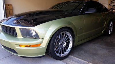

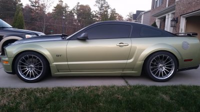

Can we see some more pics of the car with the HREs?
AutoX test and tune a few weeks back went well. Driver mod is the #1 priority. I'll be running in the season's first event in Greensboro, NC this Sunday to see how we stack up.
Winter plans (I know it's still winter, but always look forward to NEXT winter) are seats and aero. Aero will include a splitter, spoiler, and hopefully hood vent. Seats will be #1 on my list because it will help with the driver mod. The sides of my knees are always killing me after any AutoX or HPDE. It would be wonderfully novel to operate the vehicle while not being spread out bracing myself.

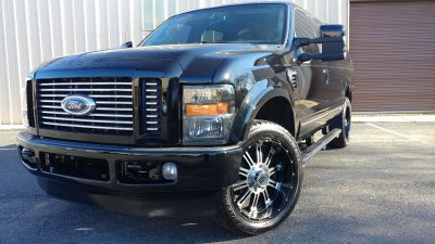

NEW HAULER
I picked this up to pull Fiona around. I don't think it will have any trouble getting the job done. Not exactly the Harley I've been dreaming of, but a nice substitute.
Boone
Automotive Enthusiast
Feb 24, 2015
320
High Point, NC
Look closer... it's not a pickup, it's an Excursion. A 2008 Harley Davidson Excursion (sort of). I do have some work to do electrically, so I could use an assist from any of the wiring geniuses on the forum. The following items on the dash are not hooked up yet, and I'm investigating how to make it happen:
In-dash Ford electric trailer brake controller
Rear window defroster
In-dash Ford auxiliary switches (total of 4)
Reverse sensor override switch
Other than the above, everything on the X works swimmingly. 123K miles on the clock, and lots of extras:
Pioneer AVIC touch screen stereo w/ nav (steering wheel controls function)
Rancho 9000 nine-way adjustable shocks (transforms the ride)
22" KMC XD Series wheels
Falken 305/45/18 wheels
Block Heater
LED taillights and 3rd brake light
LED interior lighting
2004 F-250 Harley Davidson Edition Dash
I'm sure I'm leaving something out, but you get the idea.

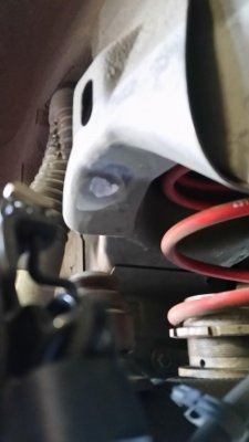

A couple of questions came up while I performed track prep this past weekend (VIR coming up this Friday). On went new DBA rotors and Carbotech XP-12 pads all around. While making the swap, I found the drivers side bumpstop was disintegrated (new ones are on the way now from Summit). I noticed the bump stops on both sides of the rear axle were contacting the sloped surface of the frame and not the flat surface above the axle.
Is this correct, or does my axle have too much rotation? I just had new gears put in the diff, and I added a BMR adjustable upper link to optimize the pinion angle. Is the contact point of the bumpstop normal, or is this an indication I have an issue? Do I need to think about cutting off the bump stop mounts on the axle and rewelding them so they contact the flat surface?

Did you ever figure out if you were having an issue with axle rotation? Cool videos btw.
Boone
Feb 24, 2015
320
High Point, NC
My 3.55:1 gears were installed at Fastlane Motorsports. After digging in, they recommended I install an adjustable upper link to correct pinion angle tolerances. If the pinion angle is in tolerance and the wheels are centered in the wheel well, then I'll live with the bump stop issue. Contact points indicate they've been hitting there for a long time, and the sloped surface will load them more gradually.
I suspect the adjustable lower arms are too short, and the adjustable upper arm is too long which is causing the axle rotation.

You need to cut the top off of that bump stop, the car is lower than stock.
