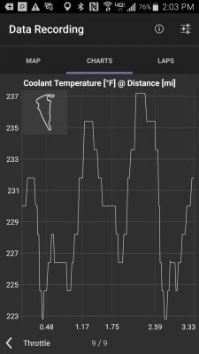

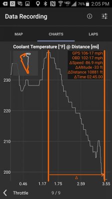

To further quantify my water temp concerns at VIR Full this past weekend, I had water temps peak at 240 degrees F, and recover to 220 degrees during the a lap. My cooling system is working well based on a 240 degree to 200 degree drop in the 2 mile cool down with 2:45 seconds elapsing. All data is from an OBD adapter charted with Harry's Lap Timer, so I'm looking at a chart, not just brief glances on track.
I have a Meziere 55 gpm electric water pump on my 5.3L BBB. The radiator is a Mishimoto performance aluminum radiator (3 row, 2.05" thick).
Does this appear to be a flow problem? Do I need more than the 55 gpm during peak power output?
Should I look at additives for the antifreeze? I believe my builder (Pro Dyno) used 100% antifreeze. Should I drain the system and go with a 50/50 mix to lower the viscosity and increase the flow rate?
I have a cowl hood. Could airflow be going stagnant over 100 mph? Do I need to add hood vents? I wouldn't think this is the issue since the rise is linear.
Any advise would be appreciated.
