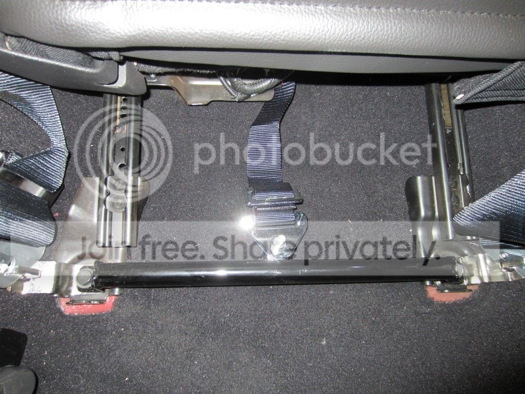

What are you guys using for IHRA approved seat belts? Apparently, at my local track, I can run 7.35 without a roll bar but I need seat belts below 7.50. I have factory seats and the rule book says the crotch strap can go in front of the seat. How are you mounting the crotch strap? Also, can I keep the factory belts for street use and add Driver restraint for track duty?

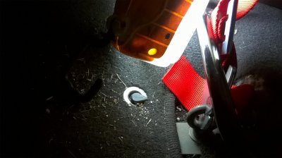

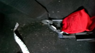

I used a 3/8" eyebolt and a snaphook for the antisub belt, and a couple 1/2" eyebolts and a D-links for the lap belts. Drilled holes and used 1/4" steel plates for floor reinforcement.
