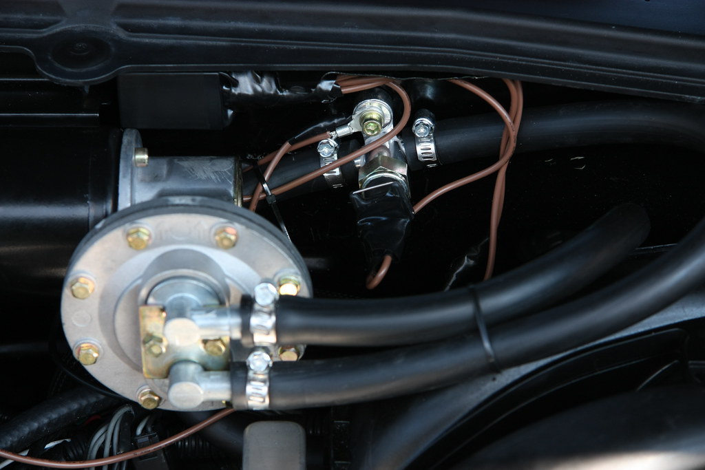

Since the cams were put in, the car would idle at ~10" (according to the gauge) and that number would sometimes go to 5" or less depending on how hot the engine is and whether or not the heat/air was on. A few times i've almost rolled into traffic with the brakes all the way down and the car still moving!!!
First tried using a vacuum canister, but that didn't help at idle at all so I got a vacuum pump from Comp Cams through Jegs http://www.jegs.com/i/Comp-Cams/249/5500/10002/-1&parentProductId=945586
Just put it in and it does make some noise but it's not bad especially since you can barely hear it over the car itself lol...

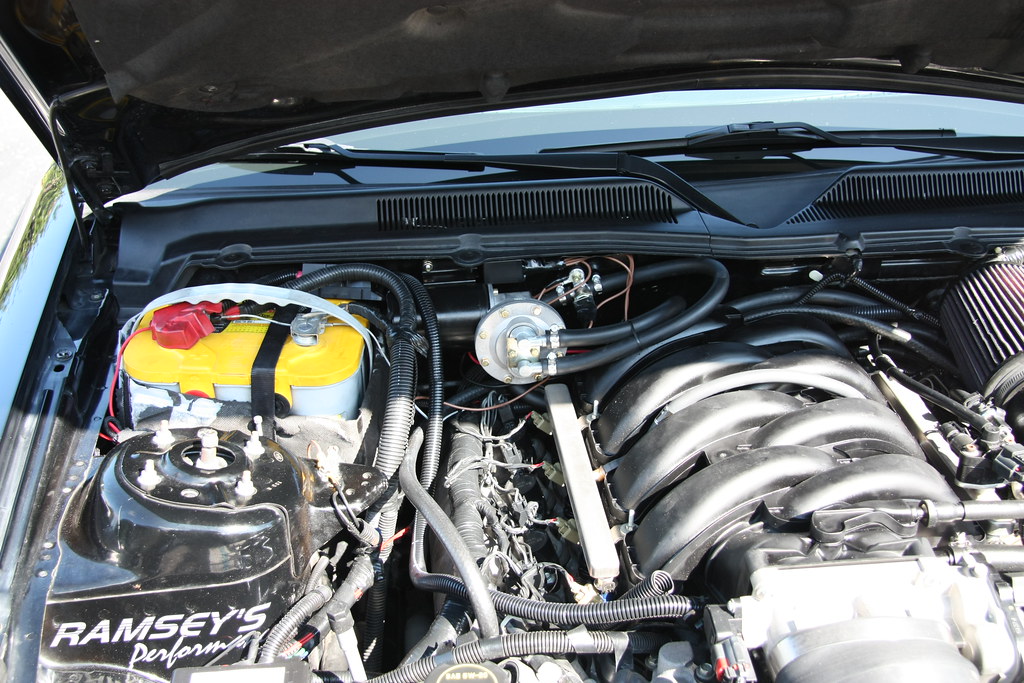

Still getting ~10" of vac on the gauge with the manifold vacuum line plugged off. The pump works off a relay, and is wired into an add-a-fuse in the passenger kick panel. The pump itself is mounted on the firewall next to the battery, I'll have pictures tomorrow... racing 1/4 mile tonight!!!!!!!! The air is cool, it's going to be faaaast. It's good to have solid brakes again.
edit: here's pictures
The kit came with rubber mounts, but that made it stick out too far and rest on the fuel rail.

The only things left to do with the pump is install an 'oh shit' master switch in case the relay fails I'll flip a switch and turn on the pump, and maybe mount a vac only gauge on the firewall cover for monitoring.
