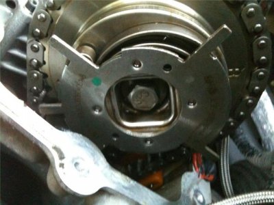

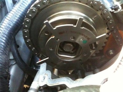

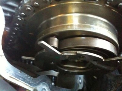

I strongly dought it is the cam install as I have had them in for a year and half with out any problem. The car only made three passes and I shift at 6000 so I know I'm not over reving her. I strongly don't think it jumped time as I have the valve covers off now and the chains are tight so no tensioner issues. The phaser on the drivers side is more unwound than the passenger side but the still pins are still intact that hold the phaser spring from unravling. I'm still lost at this point I will post pics of phasers momentarilly and maybe some one can tell that has phaser issues in the past. I noticed on some truck sites that the vct scylinoid tends to be the culprit some times. Keep bringing on the ideas to help me out and I will keep y'all informed on the out come incase any one else runs in to this problem.

Is it just me or does the phaser in Pic 4 look screwed?
it does. When I was on my first rebuild we had the phasers out and all good till one of the guys miss-handled or bumpted it and it looks twisted like that. I think it was 54 bucks for a new one.. its been a while

So if the phaser fails will it cause that code to show UPI thought that might be it but I have never seen the cam covers off so I wasn't sure what the phasers look like is it better to replace both or do I need to just replace that one
06iornhorse
Feb 11, 2009
229
Mesquite, Texas
Well if the driverside is bad the code is for bank 1 camshaft A ithought bank 1 was the passenger side so I guess I'll replace both of them.
