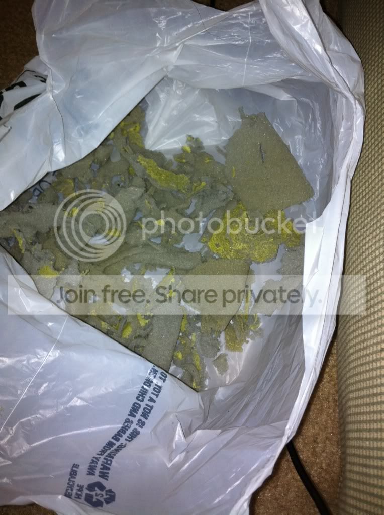

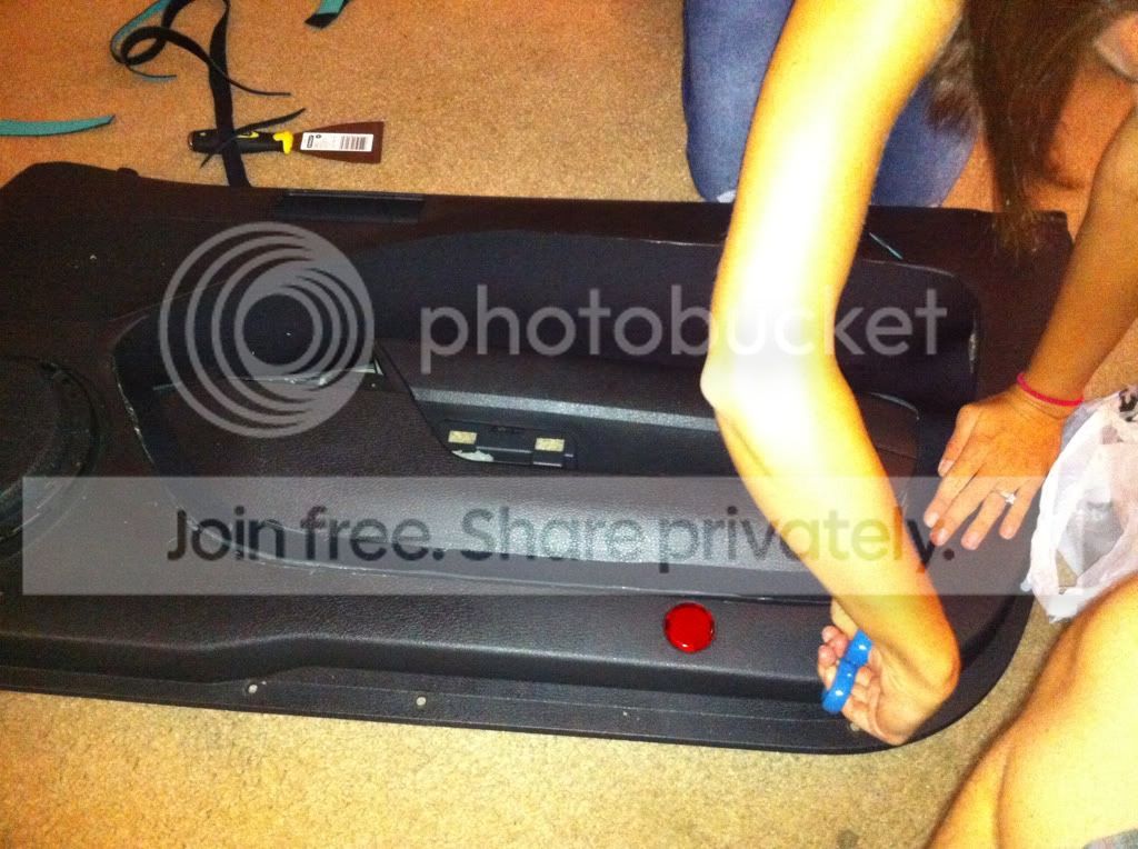

factory crap padding,.
align new padding kinda like memory foam
trim the new stuff

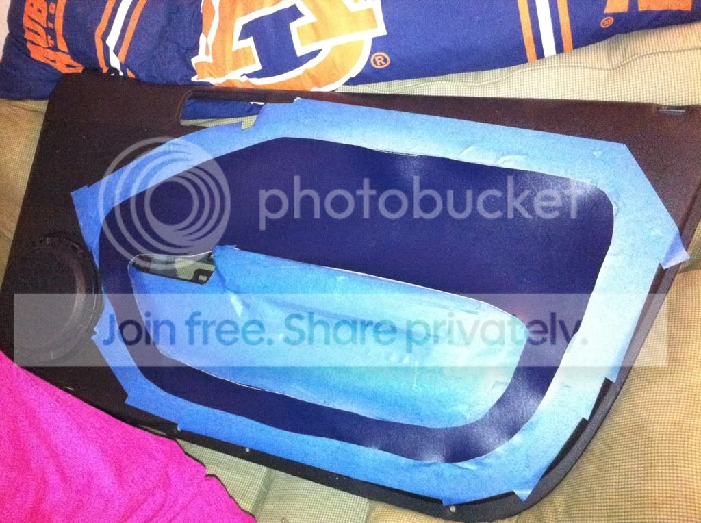

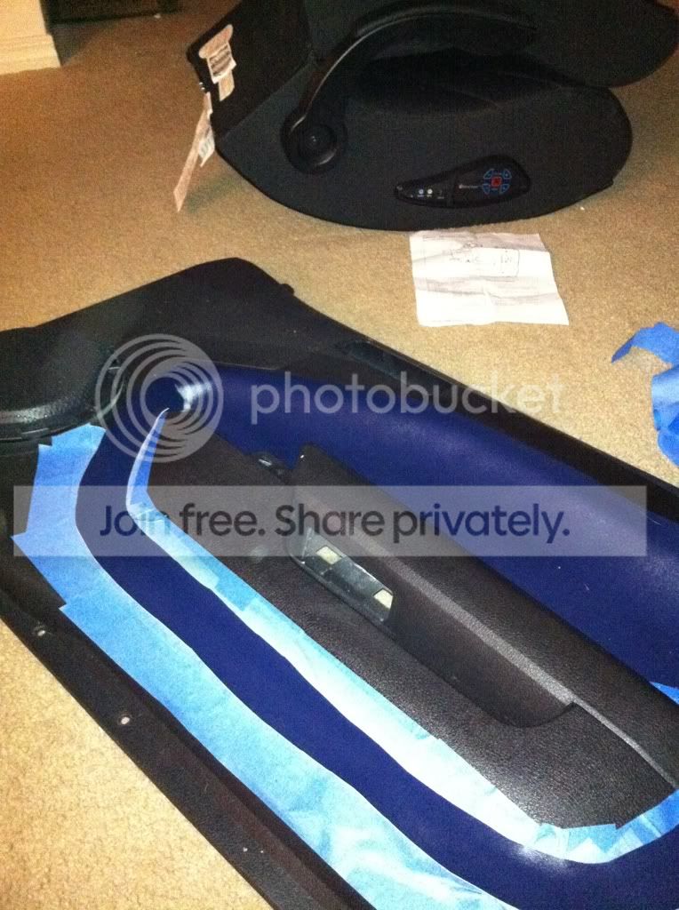

tape up door so i dont overspray with the 3m adhesive
and the new padding is on... just letting it dry

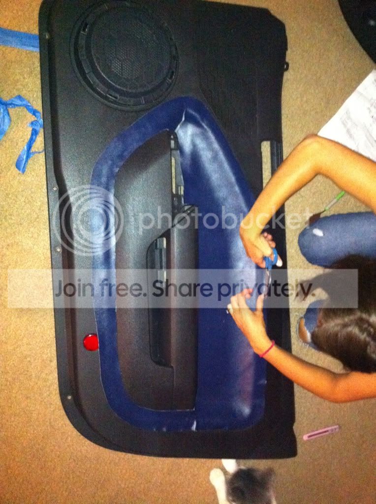

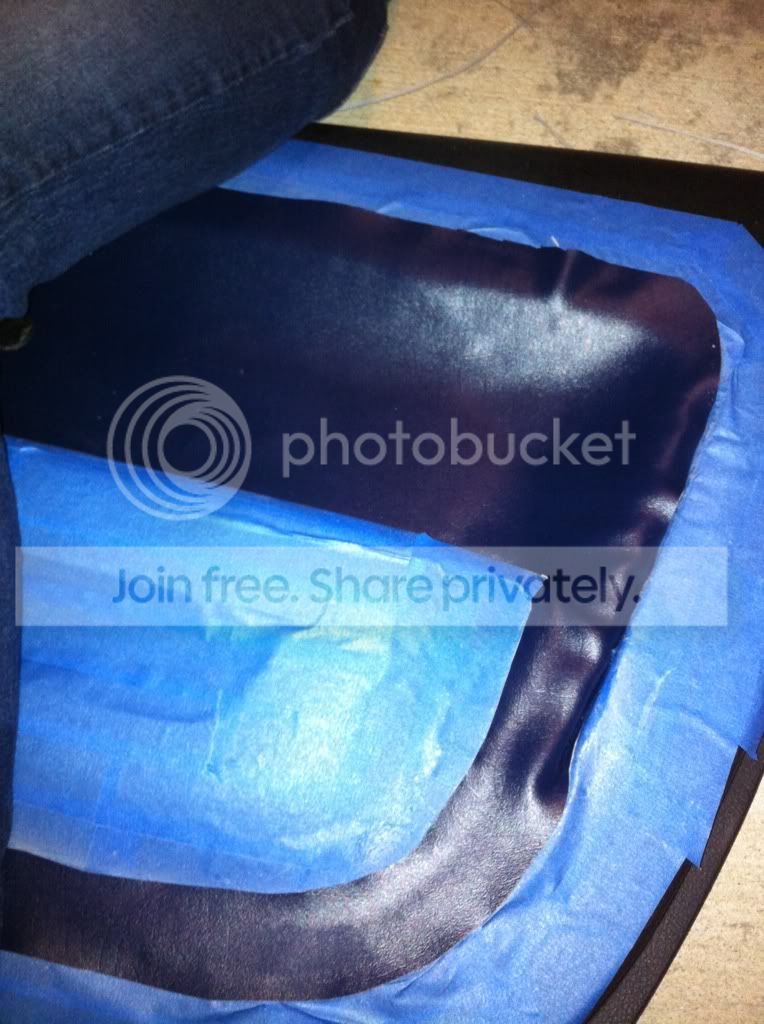

just set the blue vinyl on, just doing some last minute trimming, should be on soon...

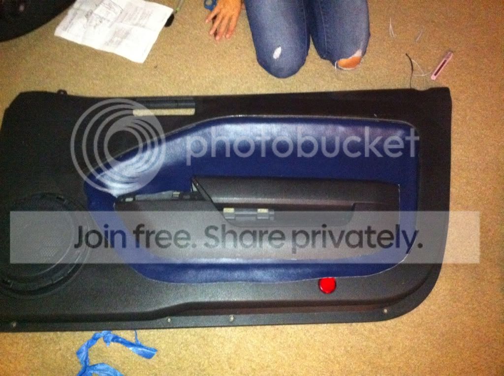

got the vinyl dowm, gonna let the adhesive dry and bond then do final trimming, remove tape and push the edges in... any imperfections u see should come out

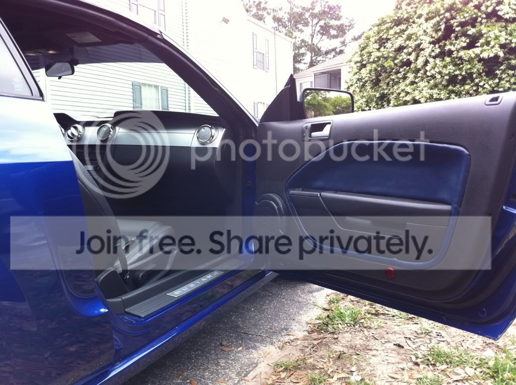

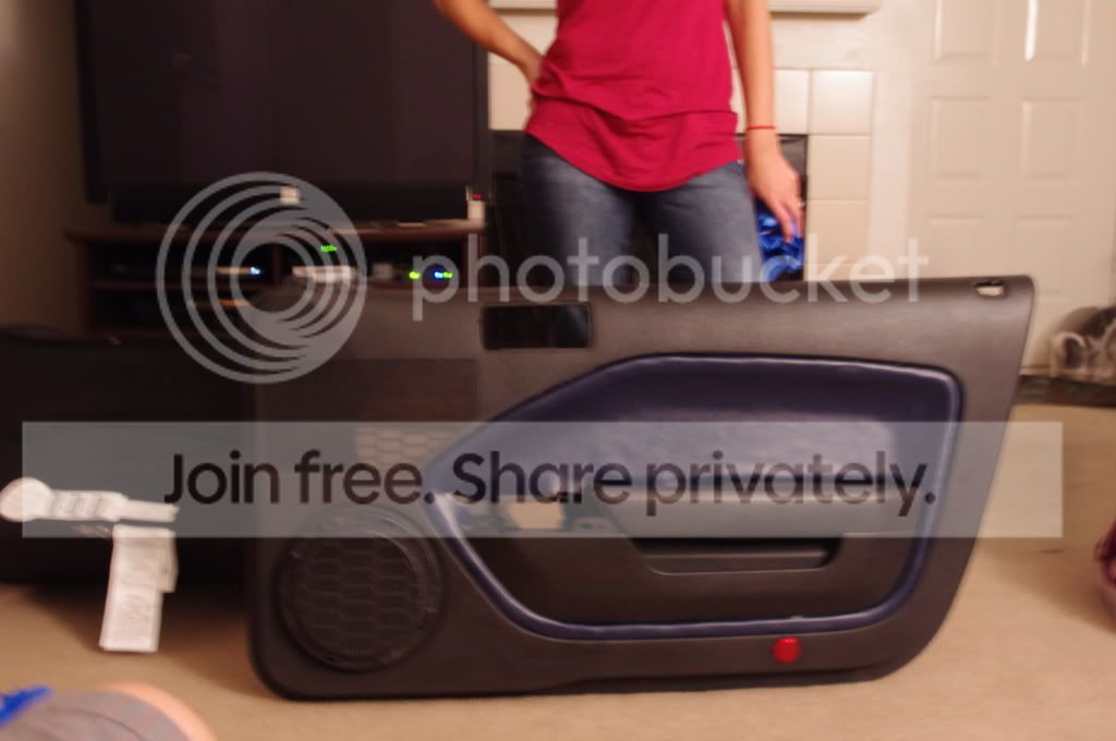

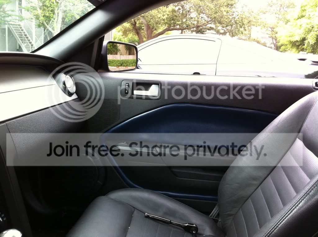

almost done, all pics so far were done with my iphone4 and the flash makes the blue a littke brighter than it really is.. we are finishing up it now, and ill try and take a few pics with the slr.... im an ameture tho..
no flash
sooo close.
