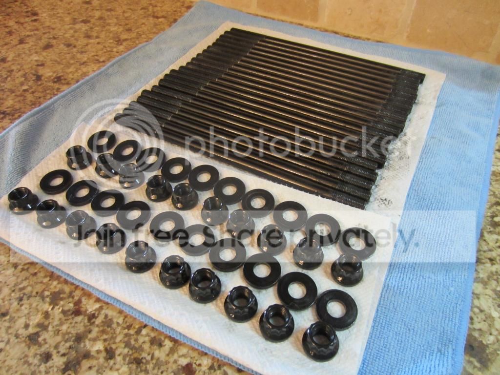

• ARP 4.6L 3-Valve Head Studs, 256-4202 – Wish List

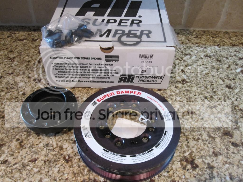

• ATI, Super Damper Serpentine Series, 918039 – On Order
• ARP Harmonic Damper Bolt, 156-2501 – Inventory

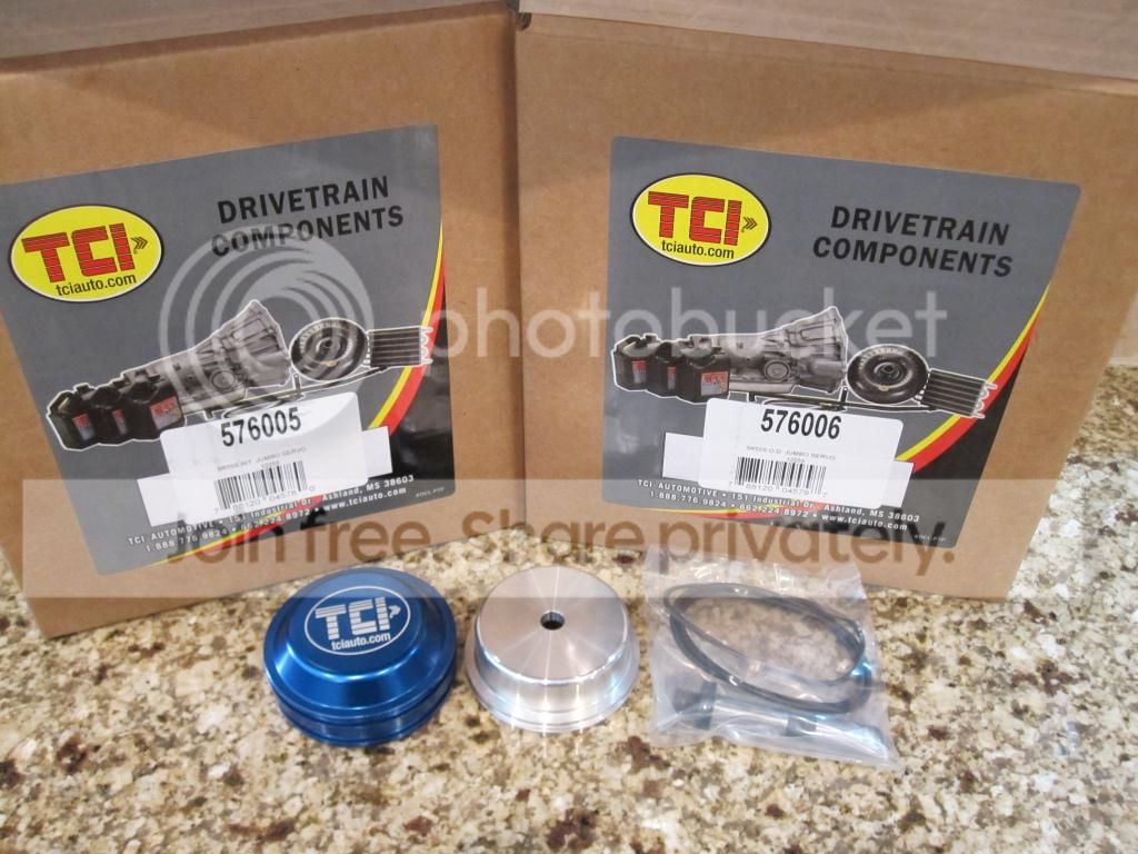

• TCI Auto Hi Performance Transmission Servo Kit, 3rd Gear Servo Kit, 576005 – On Order
• TCI Auto Hi Performance Transmission Servo Kits, 4th Gear Servo Kit, 576006 – On Order

Wow. That is quite the list. Did you get the spacer (part# 954078) with the ATI damper? I needed one to keep from rubbing on the front cover. I would also suggest ATI damper bolt #206-1001 instead of #156-2501. It is longer & the 156-2501 did not have many threads making contact when I used the same damper.
If you are interested in the Livernois Stage 3 heads, BBR stage 2 cams, & ARP head bolts (all used) shoot me a PM.
Looks like an awesome build for just "bragging rights"!
Thanks, for the information on the spacer (part #954078) I missed it! I was aware of the #206-1001 damper bolt (Mini Cooper) but was under the impression that it was only required with an Innovators West Inc damper. Thanks again.

Ordered this on Oct 11th:
Picked these parts up today:
• TSS 3V/GT500 Oil Pump Assembly w/ Billet Gears
• Metco 4-Piece Billet Idler Kit, 2005 - 10 Mustang GT 3V, MIP2005

Got these in the mail yesterday - ARP 4.6L 3-Valve Head Studs, 256-4202 (Thanks to ILW84U)
