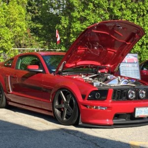

What is the backspacing on your wheels? Your set up is exactly what I’m looking for. Thanks.
Vossen CV3-R's in Gloss Graphite.
Front: 20x9 6.2" BS, +32 Offset
Rear: 20x10.5 7.5" BS, +45 Offset
PLEASE NOTE: the differential has been narrowed 1" per side.
