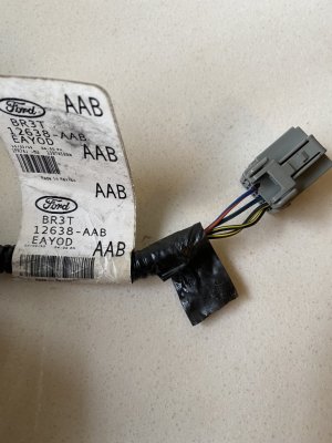

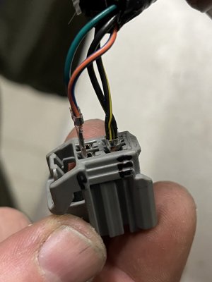

Installing a 2014 style Brake & Clutch Pedal assembly with the 2014 manual harness. We have de-pinned the pedal assembly side 2014 style connector (image 3) and need to re-pin into a 2005 style connector to connect to the existing 2005 style body harness (image 1).

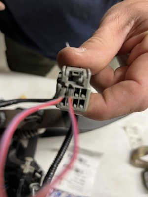

Can someone send a photo of the 2005 style pedal assembly side harness (image 2 connector with only a red jumper wire for auto configuration) or a schematic?

Here’s what I found using a 2014 style clutch position harness with a 2005-2006 Body harness.
We pulled the 2006 C215 body harness connector and replaced the Automatic jumper wire with the 2014 BR3T12638-AAB AYOD clutch positioning harness wires
Pinout 1, & 5-8 not used.
Pinout 2 red & blue from the bottom clutch position switch for starting
Pinout 3 dark purple & green from the red top clutch switch for Cruise deactivation
Now onto re-pinning the two 2006 brake switch connectors (2pins each) into the one 2014 brake switch (4pins).
