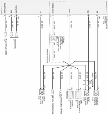

I Think its the Tune too, also I've looked everywhere for a transmission wiring diagram that says 2008 but the only thing i can find says 2005 to 07 and that even in the haynes manual! I feel like i discovered a ford mustang cover up! lol If any one can find or has the 08 or newer please email me. Also I forgot and i think this is because of limp mode but when I'm driving and I push in the clutch (coming to a light or stop at speed) the RPMs drop off hard some times even stalling the car, its really bad when I down shift in 3rd. i actually have to keep it in 3rd and softly pop the clutch to catch the RMPs. Limp Mode or possibly a clue?
cmcdowell
Oct 29, 2019
8
Also this is the wiring I used. and everything pin outs out right

So Update..... I Got the car to work! Solution was to install an Manual PCM (I Used the Auto wire harness after do the steps needs to work as an manual) and i installed a simple jumper wire on the pins under the dash where the clutch wiring harness goes (couldn't find one) Note....YOU CAN reuse the auto PCM to manual on 05 and 06 ONLY! 07 to 10 need to use a Manual PCM with PATS turn off and a Jumper wire or clutch wiring harness. Also only 07 and 08 can be swapped around the same for 09 and 10. but you cant do 09 and 08 or anything. i hope this helps someone, if you need any info please email me.
