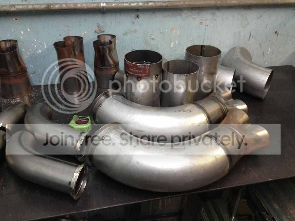

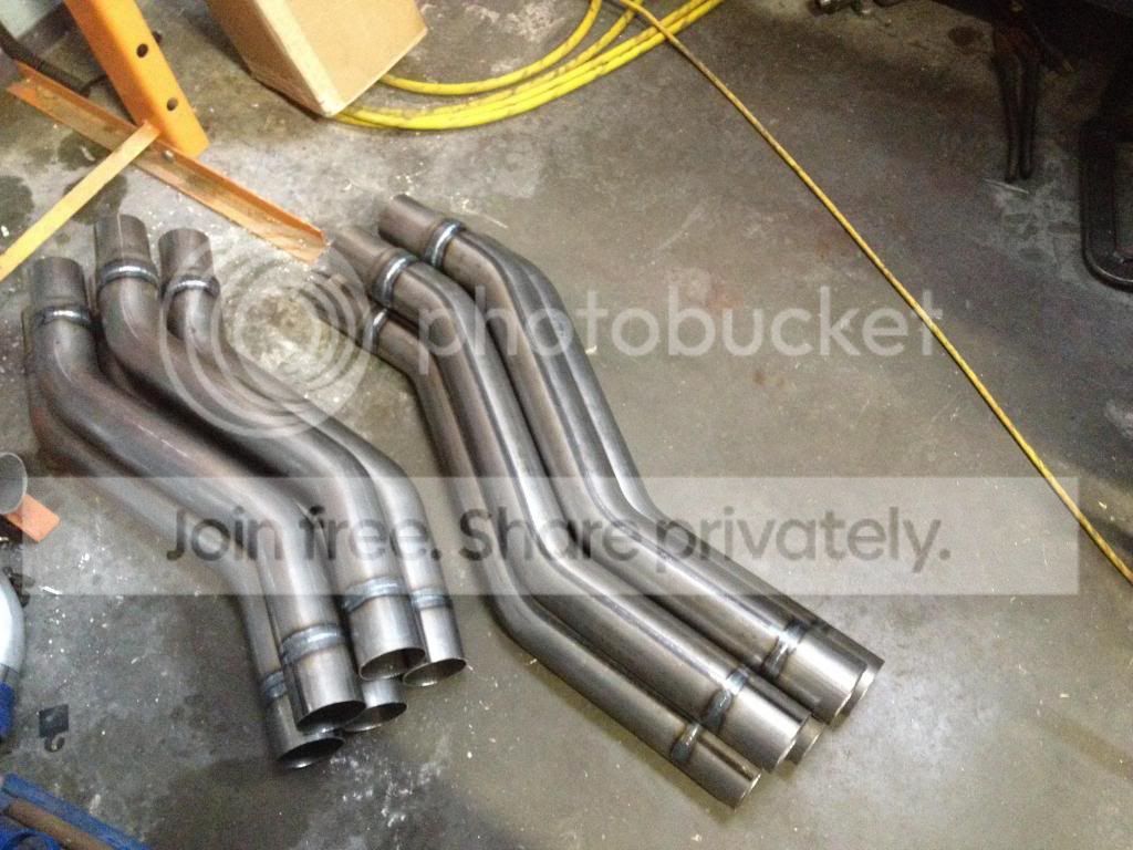

Here's the secondary section of down pipes to replace the mid pipe.

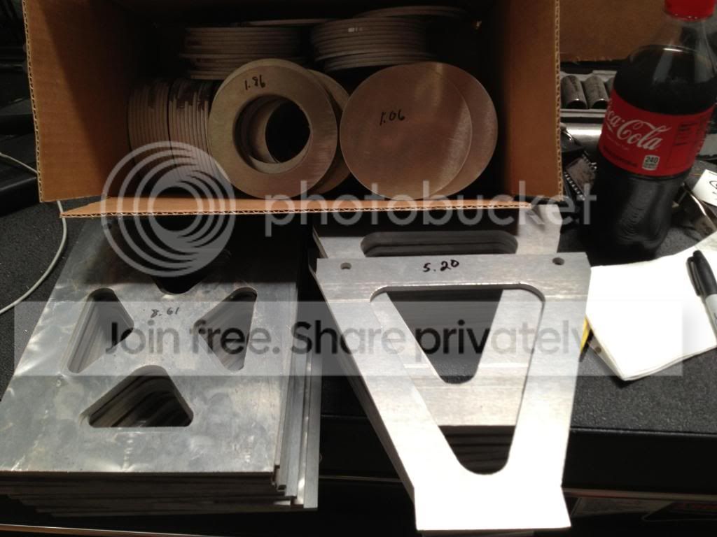

Waiting on a little material. Just a little bit keeping us from finishing up the last 10% of a few parts. Spent a little time on stocking parts. Welded on a few BOV flanges. These were before the tubing was punched out.
Some intercooler brackets and the tops and bottoms to the expansion tanks.

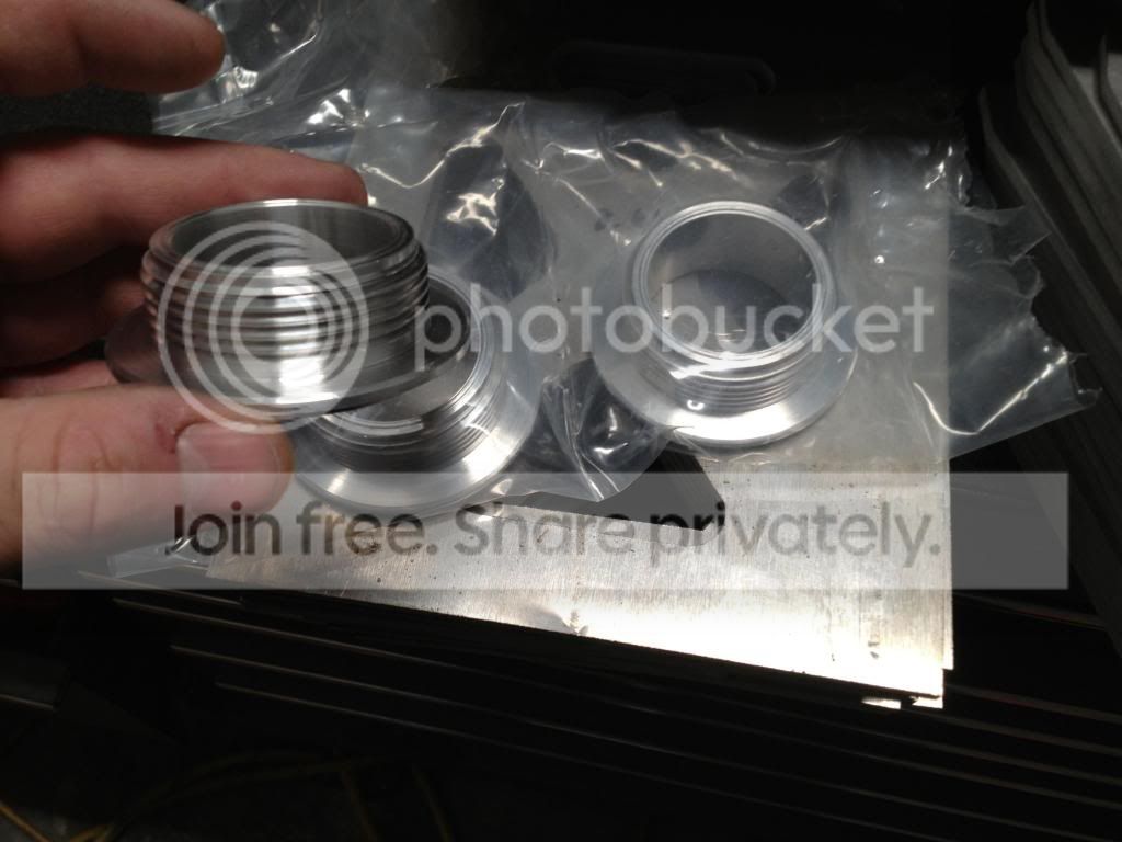

Billet thread inserts for the expansion tanks. No leaks here bitches lol
Top of the tank.

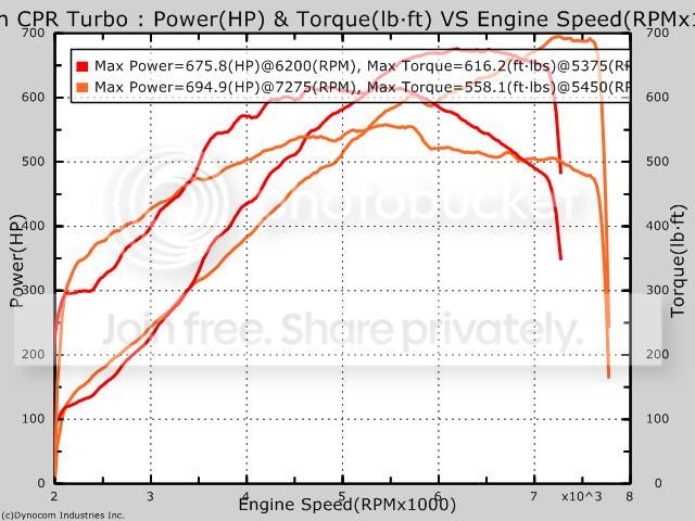

Thought I'd share some overlays. These are our numbers vs avalible blowers for the coyote. All different cars and setups. But same dyno and same 91 octane from the same area. So we've eliminated quite a few variables you can see when trying to compare numbers on different cars in different locations. All of our graphs are on 8.5psi and all pulls are on 91.
Looking into custom springs for the wastegate. We're dropping about .5psi from 5800 or so and up. Not much, but when a car makes 40rwhp+ per psi we count the split hairs! But so far pretty happy. Expect power to come in even a bit sooner with the smaller air to water intercooler which is about 80% smaller in volume.
This a TVS w a 90mm pulley and I believe a JLT intake. This equals about 8ish psi.
This was a stock pullied magnason which I believe make 7psi out of the box.
This one was a P1SC w 12psi@7700.

Short spinning cuz it's not my car lol. The AR shouldn't effect the exducers efficiency, only the inducer. But it's really small right now at .90
We just wanted to see how fast we could make it spool for stock engined customers. Not my cup of tea but still works well and its fat ass still runs 10's. when we turned it up it made 700ft/lbs by 4100 and kept climbing from there. That's just stupid lol
So right now those numbers were w a 74/82 on a .90
We've tested a few turbos and another 4 or so here pretty soon. In the next month to month and a half we'll test another 4-5 on T6 setups. The power per pound of boost will only go up from here.

Cams I think. Especially exh. Even advanced all the way it still only has an EVO of 48.5 btdc iirc on a GT. Kind of reserving final judgment until we try more turbines. The one in this car has some odd characteristics. We'll have some testing soon w stuff that should be sub 1-1 back pressure. I'll see if we can get away w more rpm despite short duration if the back pressure is super low.
This was a STD/MPH graph I used in a thread, so subtract about 25hp/rwtq on both.
But you can see when we had a rise in boost how much peakier it looks. Now it shoots to 8psi, bows up to 8.5 and comes back down. The power curve is mostly the boost curves doing. You can see about 130mph mark and sooner there is more meat under the curve on 8.5psi than even the blue 11psi line. That was a little boost controller and out smarting the damn ecu to remove about 10deg of overlap we had trouble kicking.
