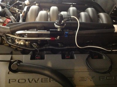

I have been working on this install for a few weeks now. I wanted things to be a certain way, so I decided to piece my kit together and perform the install in stages, while keeping within my budget. I think it's going well overall, but I have had to cross several hurdles along the way. My latest hurdle is nitrous and fuel lines from the nozzle to the solenoids. I initially ordered lines that were too short. I also feel that I need 90 degree elbows on one end of the lines to make them more flexible for my application. Here are a few pics.

Test fitting everything is very necessary to get things right. It has helped me to discover several things that needed or still need to be changed.

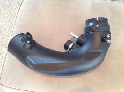

Nozzle adapter and nozzle.

Fuel rail adapter and Hobbs switch.
NoSlo5oH
Aug 15, 2012
103
Fuel rail adapter and Hobbs switch installed on fuel rail.

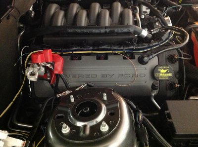

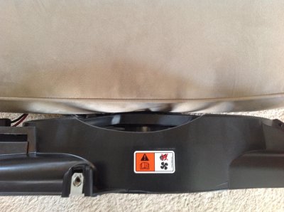

I had to trim the cooling fan shroud to gain clearance for the nozzle when installing the intake tube (nozzle slightly touched fan shroud and didn't go on as easily as I would have liked it to).
NoSlo5oH
Aug 15, 2012
103
Another pic of fan shroud.

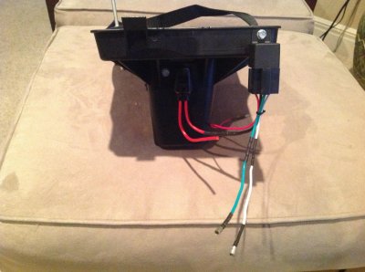

Battery tray with relay and fuse holder mounted.

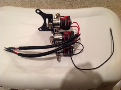

Pic of solenoids mounted on bracket. Note: This solenoid bracket cannot be used without the spacer or a plate kit.
