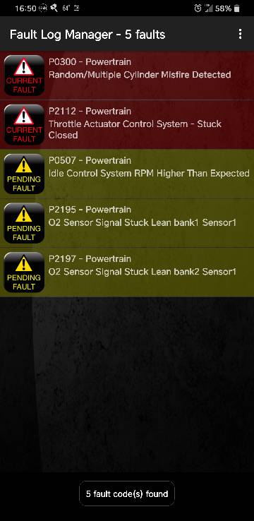

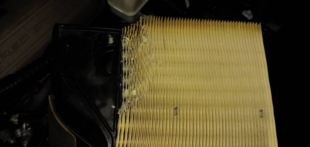

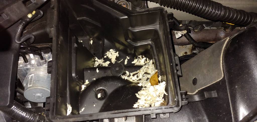

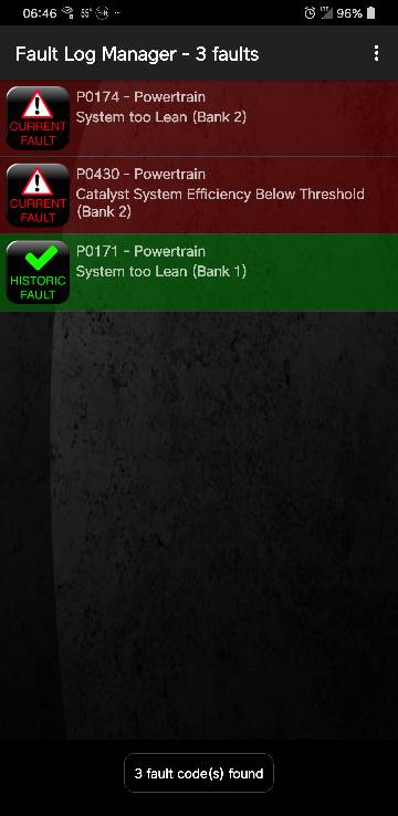

Guys I need some advice. A rodent crawled up in my filter housing and chewed the paper filter (see attached pictures). The car stalled and pegged on multiple issues due to the filter being sucked into the throttle body. I pulled the housing, throttle body, and vacuumed out all the debris. The car seems to run ok now (no O2 sensor faults) but the idle rpms jump around often and the cat efficiency pegged after running it for a few miles. I'm going to change the plugs this weekend and see if there's any other damage. Do you have any advice or suggestions?

Damn!! I would pull plugs and make sure all looks good with a small borescope if you can. Swap in a fresh set and go blow the crap out of it with a spirited driving session. Rinse and repeat if needed.

The paper should go through the engine without too much fuss and not cause any damage. Unfortunately, the paper will plug up the converters since it can't get through that point. I don't think the paper will burn off and it may end up fouling the converters.

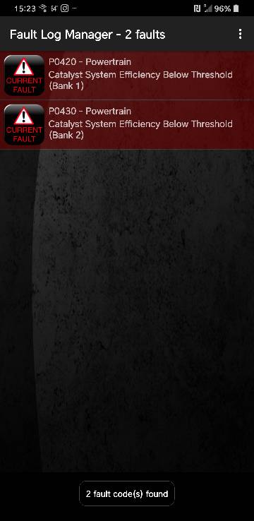

That's the problem I think I'm going to have so after this weekend's plug change and cleanout, if it still throws the cat codes I'll have to have them replaced.

Hey kp I live in a suburban area. We always keep our hoods raised-part way or fully open. This seems to deter rats and other rodents-they cannot hide that way. I have tried moth balls , red fox urine , and cotton balls soaked in peppermint with some success. On an older Camry we had I put some steel wool in the air intake tube. Rats do not seem to try to chew it up. Good luck.

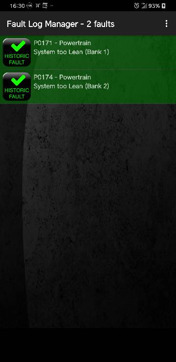

Thanks for the suggestions. I did change the plugs which looked pretty bad, and cleaned the throttle body and Mass Airflow Sensor. Ran good for about 50 miles, then I threw some codes.
I have them cleared for now, but I'm logging every drive to see if I can find where it's going wrong. I still have the power train warranty, but I know the O2 sensors are no longer covered (2year 20,000 mile) but the cats are covered (up to 80,000 miles). I guess I'll just have to see what flags and take it to the dealership if it doesn't work right.

Final follow up. Took it in for warranty work. Mass Airflow Sensor was bad and the PCV valve was sticking. $100 for diagnosis and repaired under extended warranty. Got her back running like she should! [emoji16]

Cat codes came back, but I took it back to the dealership and they replaced them on the extended warranty. [emoji16][emoji16][emoji106]
