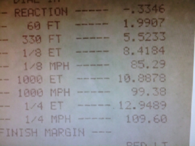

I guess I`ve been a Bad influence on my son and daughter. I have been drag racing Mustangs since the late 60`s and my son RBS550 & daughter Foxy Stang Girl have been drag racing with me for many years. My son just purchased a 2015 GT Auto and straight to the track where he made passes bone stock with the window sticker still on it went ET 12.94 @ 109. We were very happy with the bone stock passes. He plans to race at the next three MNRA races,

12.94 @ 109 1.99 60'
Bone stock including tires & tire pressure 37lbs.

ET Time slip
Breaking in the new S550 Mustang, Base line set after many passes in the 12.90`s Bone stock ,ready for mods!

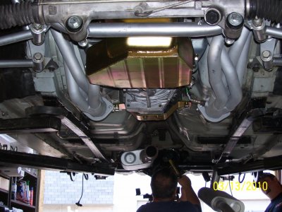

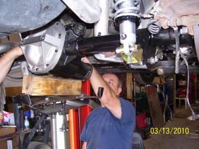

I will give Kelly at BMR a call I have been researching BMRs IRS parts, I plan on dropping the IRS to change the shafts & maybe gear change. I have worked on some of the older Cobra IRS in the past. The pic is not a cobra but lot of mods I did from motor to the rear end.
Thanks for the info

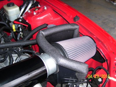

May I ask why JLT CAI?
I understand not much to gain from any of the CIAs MAYBE 8 to 10 hp if that. If it is 10 hp with other mods that could = 1 tenth at the track about 1 car length. My dad runs JLT on his 05 here is a pic where I modified it with some high temp ABS and foam trim to seal it up to the hood to make it more of a Cold Air Intake not HAI, Also not in the pic is enlarged fresh air opening. Thanks for the input
