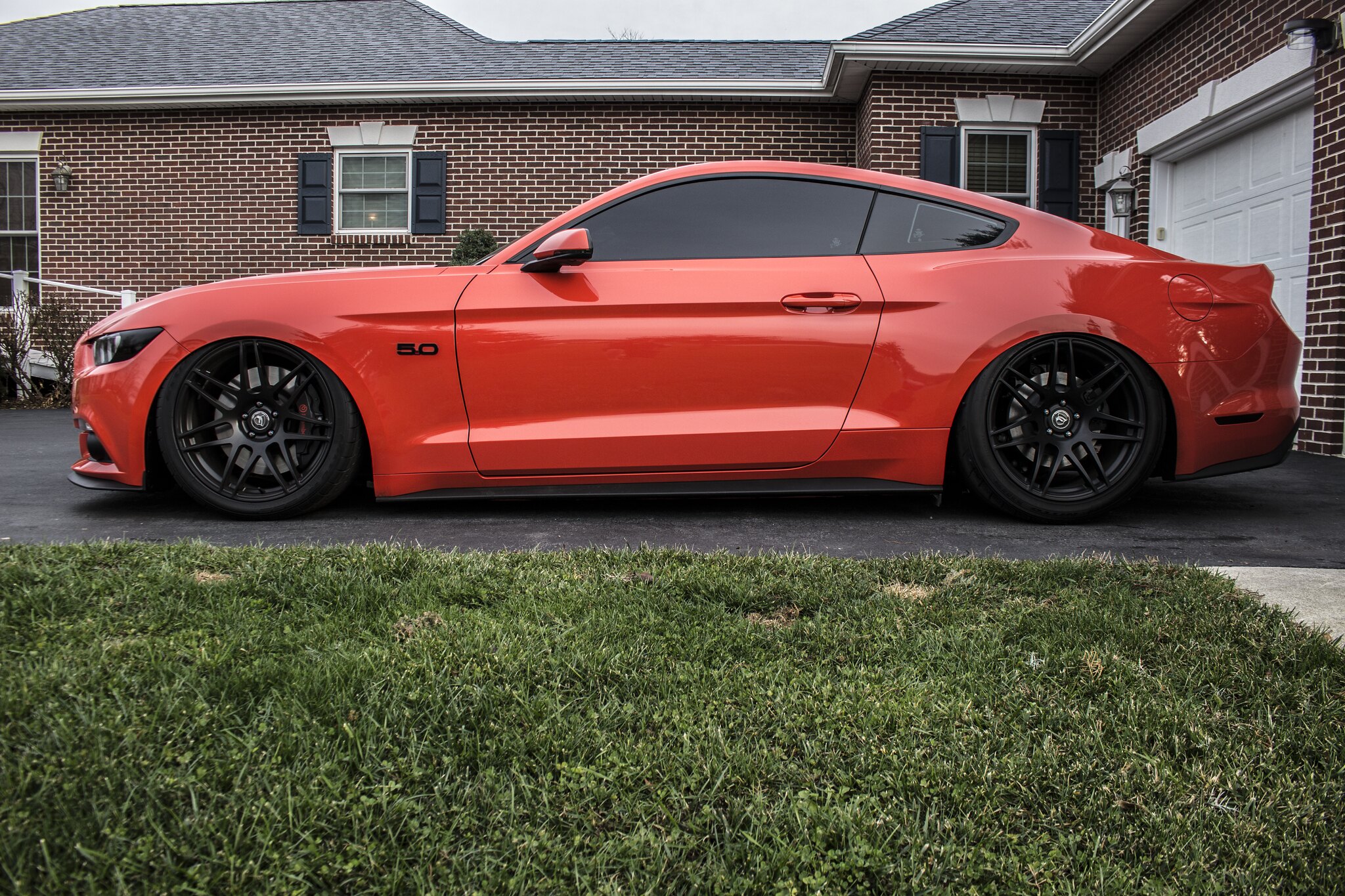

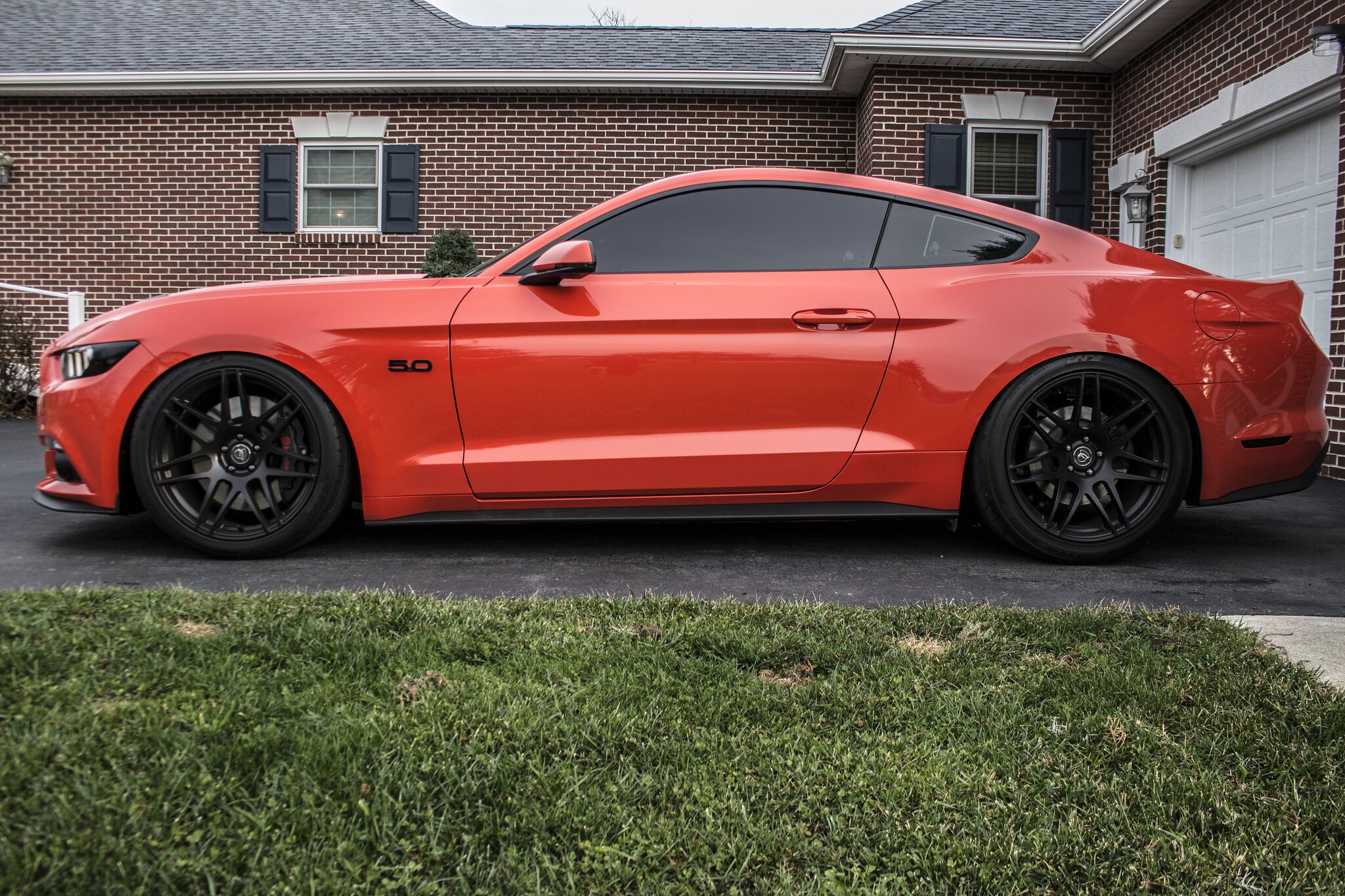

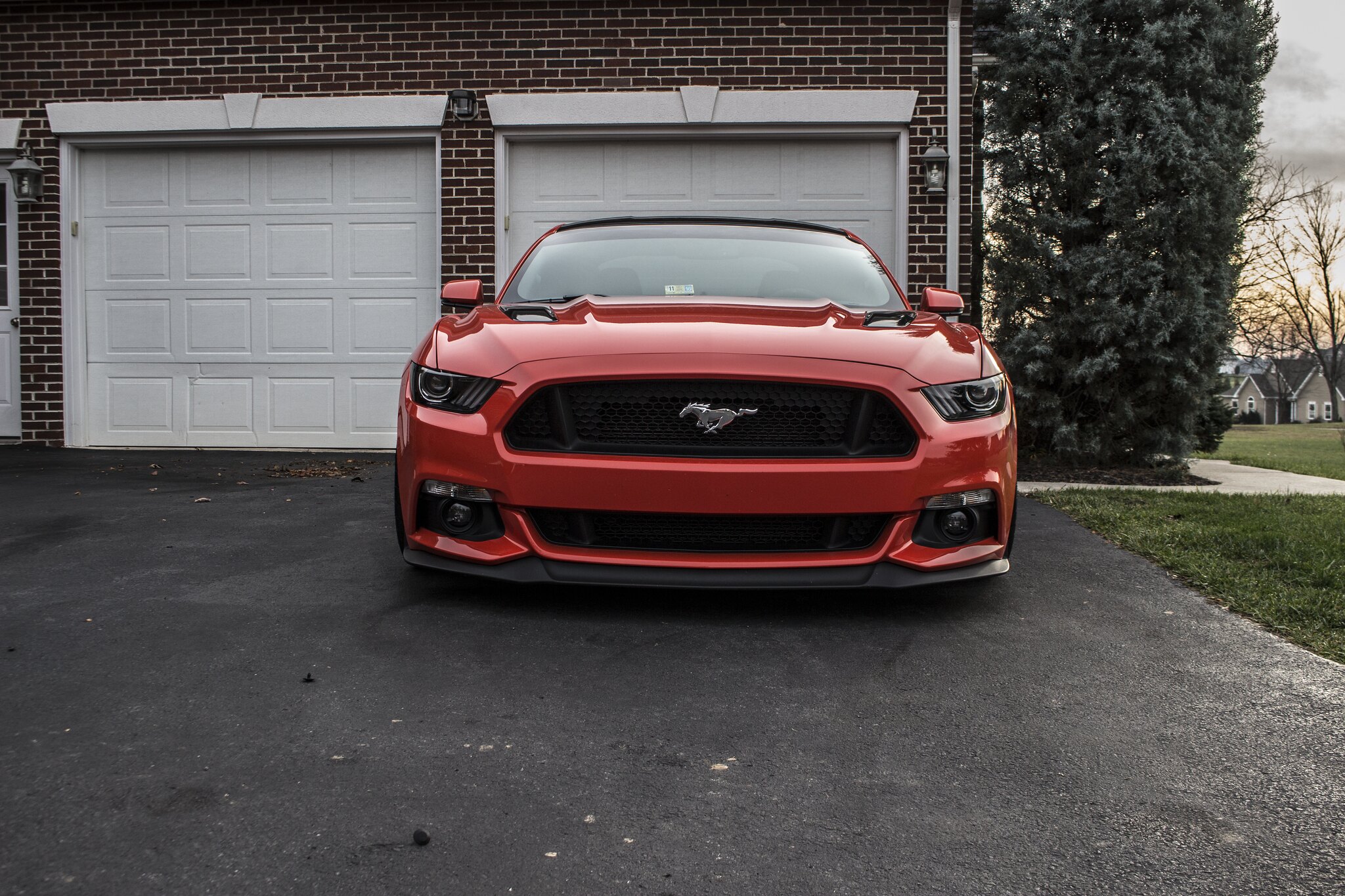

Couple pictures I took yesterday,
Before Airlift, Side view:
After Airlift and F14's, Side view:
Side view, ride height:
And a front shot just because lol:

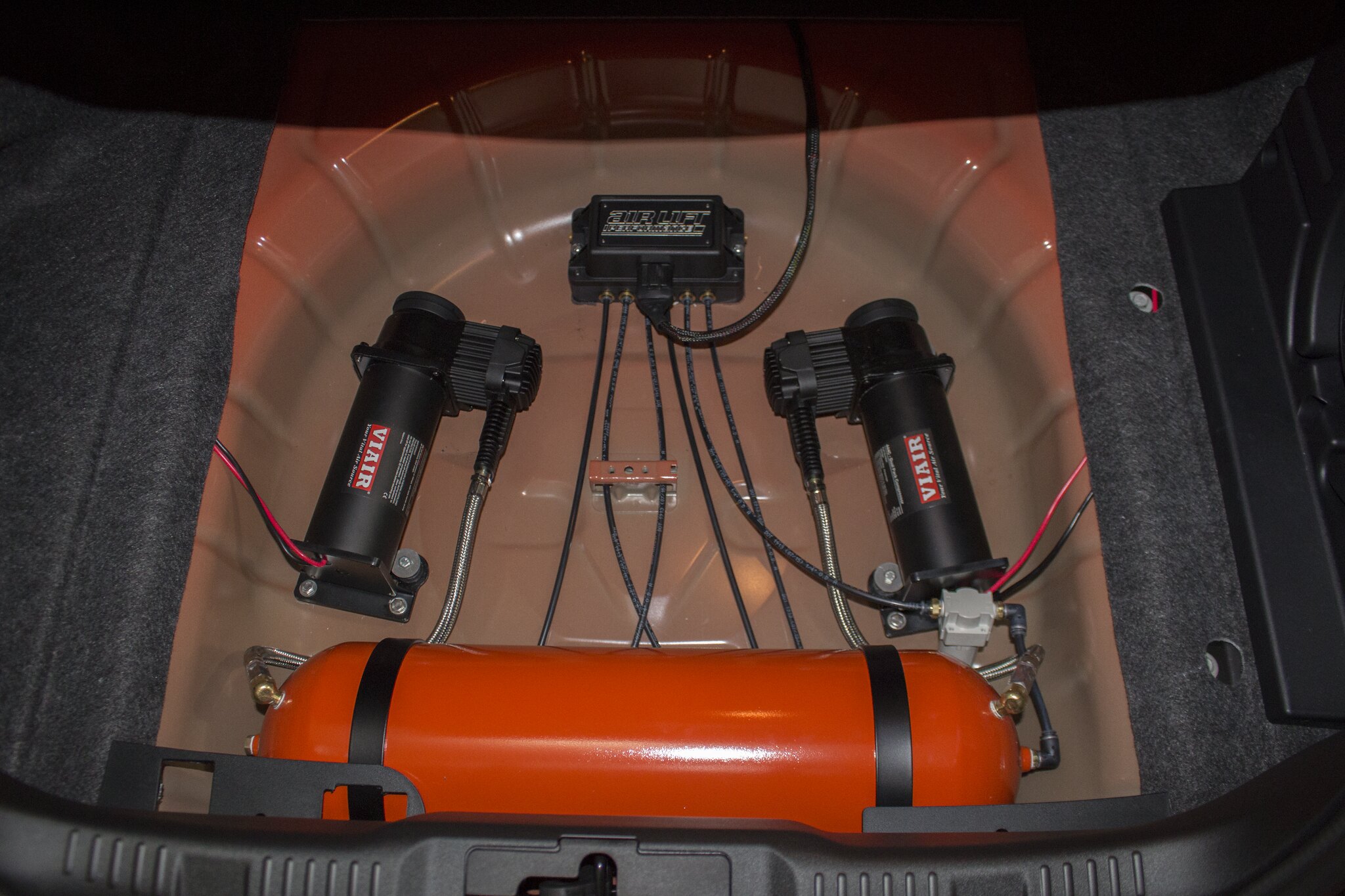

That looks absolutely awesome mate. Love it. Got the same planned for mine.
Any more info on the compressors? They look different to the other ones i've seen on S550 installs. Side mounted. Do they have the isolators on too?

Thanks! Sorry I didn't go into more detail on those. They are dual VIAIR 444c Compressors (Black Powdercoat). I was able to move to the mounting brackets from the bottom, to the side holes of the compressor with just an alan wrench. Yes, I also have the isolators attached to the bottom as well. They seem to be working pretty well as it's pretty quiet, but I don't really have a comparison to offer.
I really wanted to do a stealth install to where I could open the trunk and not even know anything was there. I'll upload a picture of the trunk with the cover over everything tonight. Let me know if you want any closer pictures of anything!

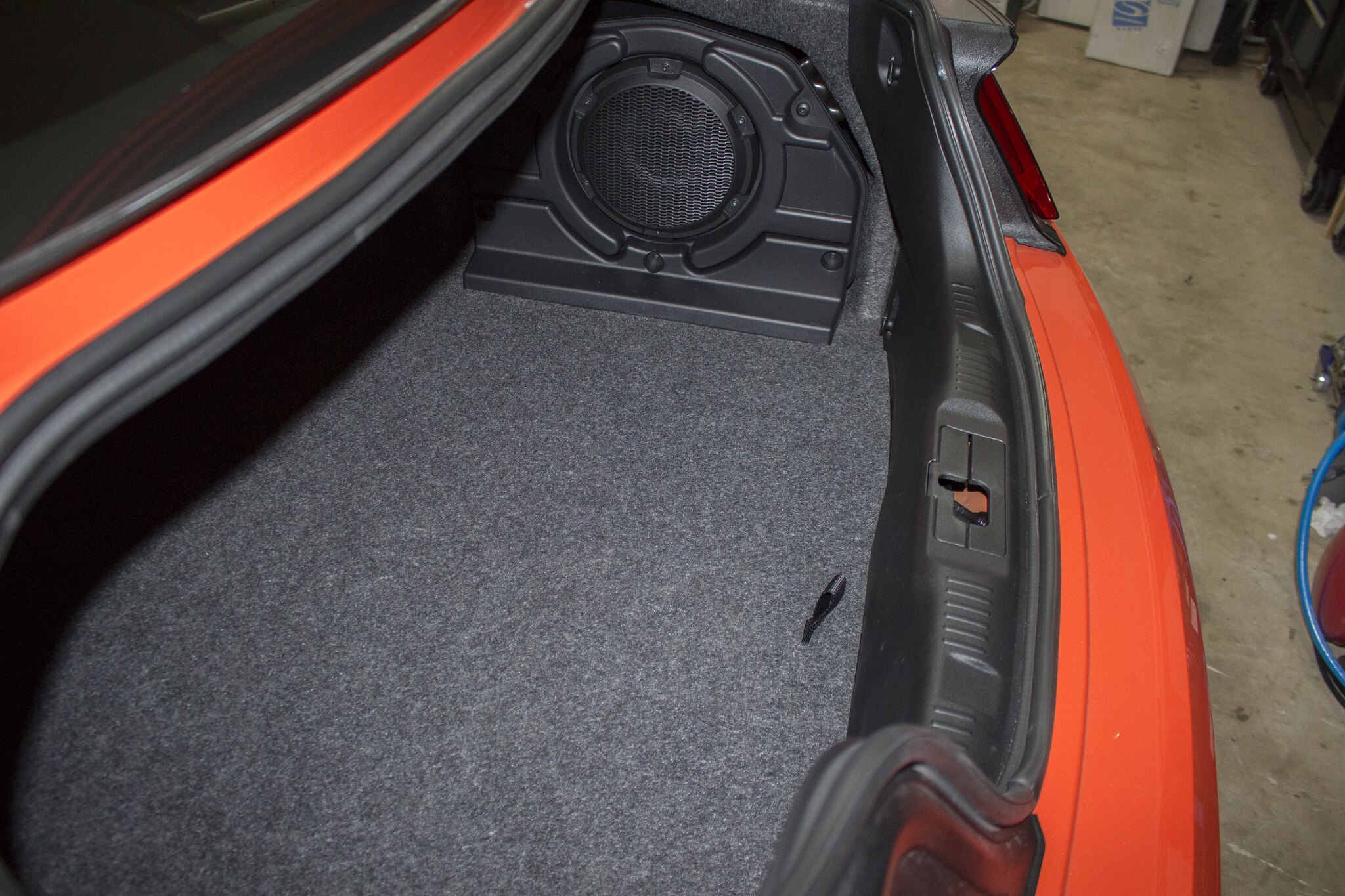

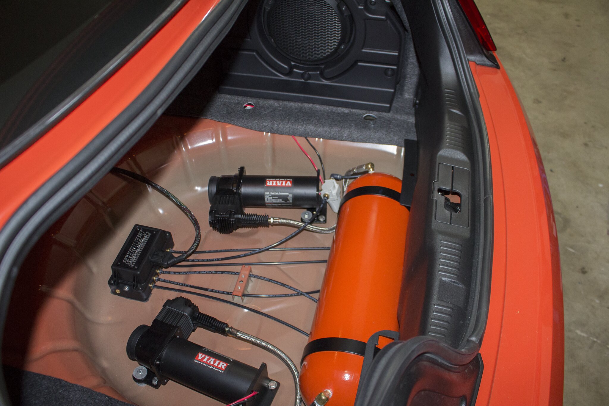

Here's some pics I took tonight. Top 2 are with the cover on, retains full trunk storage space. Bottom 2 are with the cover removed. Only Modification I had to do was cut the fuel nozzle attachment off at the bottom left.
