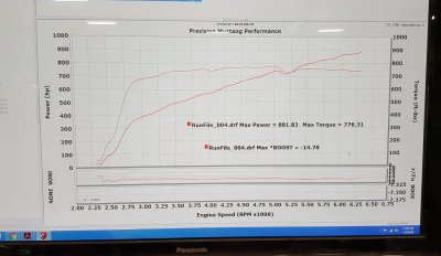

So basically the 6200 kit includes the manifold, blower, intake, a pulley, belt and what else?
Probably an intercooler, pump and some plumbing. I already have a KB kit so in wondering what else I really would need. Just in case...
No, it comes with a very basic Bosch intercooler pump and a small intercooler. I had an AFCO dual fan intercooler but sold it and used the supplied KB intercooler and pump. I added a Killer Chiller, too, though - that's why I ditched the AFCO intercooler. FYI, it's cool here right now so the Killer Chiller was not on for any of my dyno runs. Not needed right now.
The KB kit was complete down to the last bolt and zip tie - quite impressive actually as to how complete the kit was. They supply everything for the basic install - all heater hose, clamps, brackets, etc. It came with my choice of two pulleys, too. I already had a Whipple setup before so I had fuel injectors, pumps, etc needed.
I did add a GI Joe 8 rib kit, also.
lskiller
Apr 11, 2015
109
LOL.
I'm sure you know why I asked. Corrected numbers are a good equalizer imo unless it's forced induction at 5000' which you clearly are not at. Uncorrected are nice to know to, just to know what the motor is actually feeling stress wise.
Thanks for the info. Good Lord that's gotta be a handful. Is there a goal or is it more of a "see what it will do" build? Will you get kicked off of the track when you break 10?
It's not really that bad - take some getting used to for sure. As far as goals... not really a hp goal but I want to be able to coast to 9 second 1/4 miles basically. I pushed my old Whipple 2.3L to the max and it was awesome but in the end I just ran out of blower. I got it down to a best of 10.12@137 and fully expect to run easy 9's with the KB once the tracks open up again.
I have a 6 pt NHRA rollbar already - I think it's good to 9.49 or 8.99 in the 1/4. I am looking at some sort of in cabin fire suppression system for the car as well.
If I do go to something like NMRA, though I'll keep the car in the 10's to avoid the headache associated with running 9's there. Pulley swap and simple tune adjustments will do that.

Couple questions. Are you running a 170 degree tstat? Are you running a stock or upgraded belt tensioner? I'm using a UPR billet tensioner on mine.
lskiller
Apr 11, 2015
109
I'm very much looking forward to seeing this thing tear up the track! Sick build my man! :happythumbs:
Hey, I have a Reische 170* t-stat. KB included a t-stat in the kit but I already had the Reische so used it.
I have the Thump Racing belt tensioner with an 8 rib belt setup. I expected slip with that 2.75 pulley but I haven't seen any indication of it yet. If slip becomes an issue at some point I may go to a 10% od crank pulley then back up to the 3.0 blower pulley. That would give me a very slight (1psi or so) increase in boost with the advantage of a larger blower pulley.
