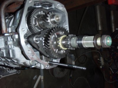

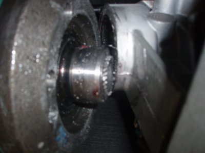

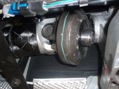

anyone ever seen a TR6060 break an output shaft... this happened to a friend of mine, and we are pulling the trans apart... it was a smooth break... not real sure why it broke but it broke right at the end... tranny didn't even loose any fluid...
Twisted one and twisted and broke another! If you also twisted it you will have to cut the shaft into to get the gears off. Bill
heck yeah, it was a nightmare... chipped one gear try'n to pull it off too! we finally got it back together and got it going... getting the gears off the shaft was horrible!
