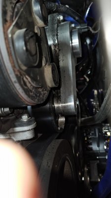

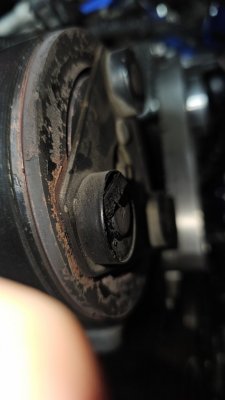

I don't know anything about compressors. Is this one dead? Sure made a mess.

Can't really tell from a picture. You'll probably have to take it to a shop to have a vacuum put on the system to see if it holds (no bad seals) . Once the system is discharged they can also pull out the orifice tube to see if it is all clogged with metal shavings from your compressor.

What's that seal in the front that blew grease everywhere? The compressor is not seized. The system did start blowing cool (not cold) air again after it happened.
Could I replace the compressor and receiver drier myself and then take it in to shop to check for leaks, vacuum the system and charge it?

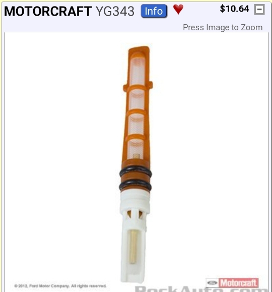

In the OP's 2006 Mustang... #3 in the diagram is where the orifice tube is located. You have to disconnect the coupling, item #2.
Motorcraft Part # YG343

Yeah M2... I thought Ford had liquid line with integral orifice tube. Only thought GM had the replacement one...

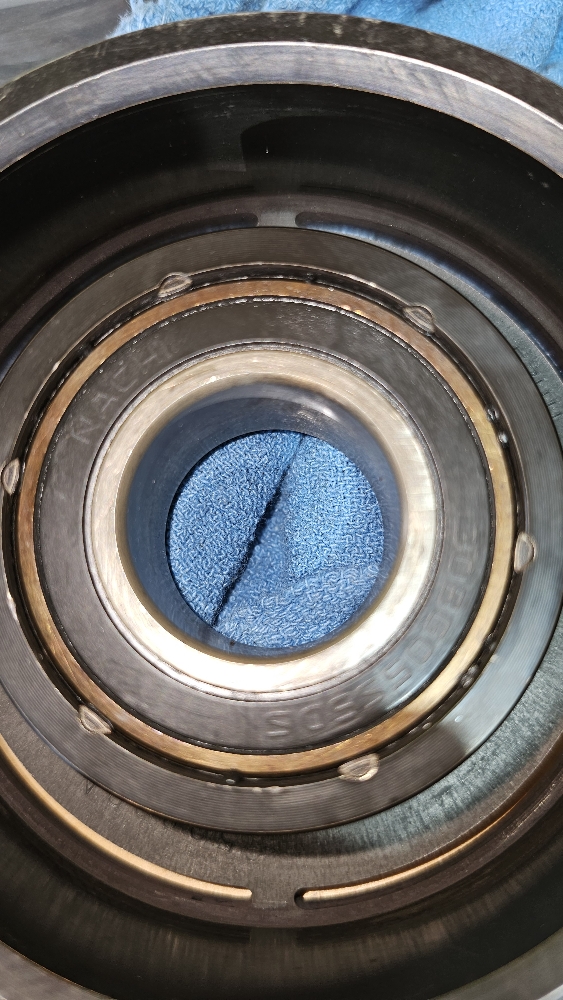

Took the hub and pulley off and the pulley bearing is shot. Probably affected the hub which blew one of the deteriorated top seals. The coil seems intact.
Ordered a new bearing for $25 and a new hub for $30, both will be here tomorrow. We'll see how this works. Need to pull the old bearing out and swap out the new one. Other option would be a new 8 rib pulley which is $86.

Will these 6 divets keep me from removing this bearing? I've whacked it a few times and hasn't budged.

I would replace the compressor assembly and not mess with piecing it together. It if you want to just try replacing the pulley... Just buy the new Motorcraft pulley with the bearing pre-installed. They also sell the pulley and clutch plate combo. Messing around with removing the bearing is a hassle and while you might get it out... Getting it back in and secured with the tangs is another story.

I second this, especially if that's the original compressor. A new compressor for your car is like $120-165 on rockauto

Agreed. I bought a new pulley yesterday. It will be here Thursday. I'm running an 8 rib set up so pieced the clutch plate and pulley together. The coil seems fine. Guess we'll see how it runs. May have to change out the compressor, hopefully not.
