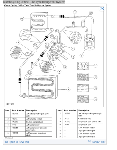

My ac has stopped blowing cold. The Freon levels are fine and I’m thinking it may be the AC low pressure switch… I can’t find it at all!!! Does anyone know where it is? Can you send a picture?

High Pressure is forward of the compressor in the line. Possibly under the radiator shroud area. Low pressure is drivers rear Corner on top of accumulator

Could be a number of reasons why the AC has stopped working. You need to use a manifold gauge set to check out your high/low pressures with the AC on/off to see what the system is doing.
