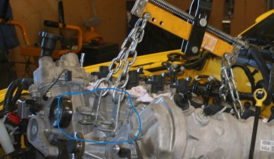

The front is hooked up as shown and the rear are hooked up to the upper transmission bolts.Out 003.jpg

After you remove the intake manifold it's obvious where to hook up the hoist. A leveler as shown above is super helpful, $40 on Amazon or at Harbor Freight.
