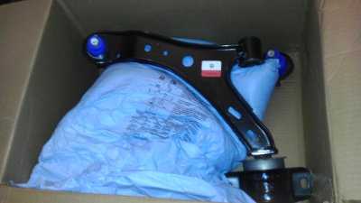

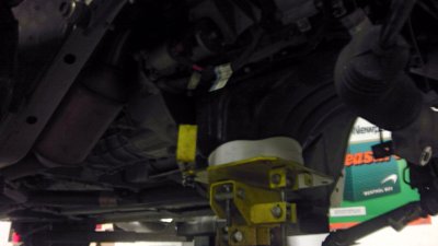

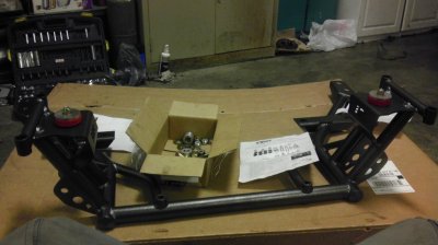

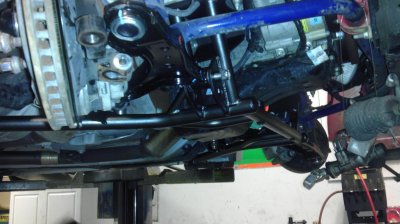

Ok guys got the K-member installed this weekend.Parts came quick and Install was a breeze. I used my buddy lift and tranny jack. Some people said to use a phonebook to support the engine under the oil pan, which was what i was going to use but at the last minute before walking to the garage i saw paper plates in my friends kitchen so i grabbed a handful of those and they really did work.
By the way this install was on my dads 07 shelby gt, but after driving it and installing it i am going ahead and ordering it.
