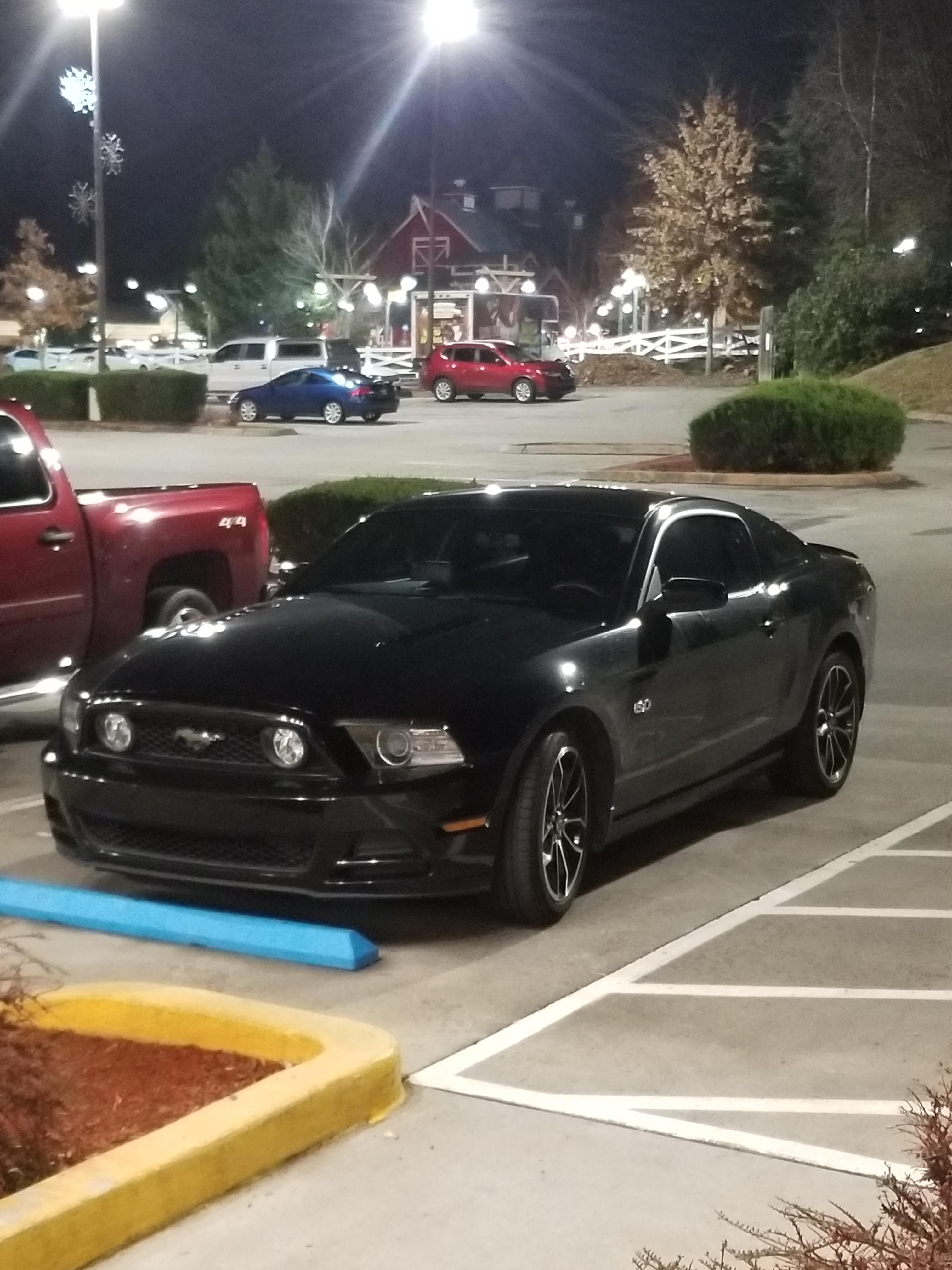

I have a 14 gt with grille lights. My question is can you run cs fogs at the same time as the GT fogs?

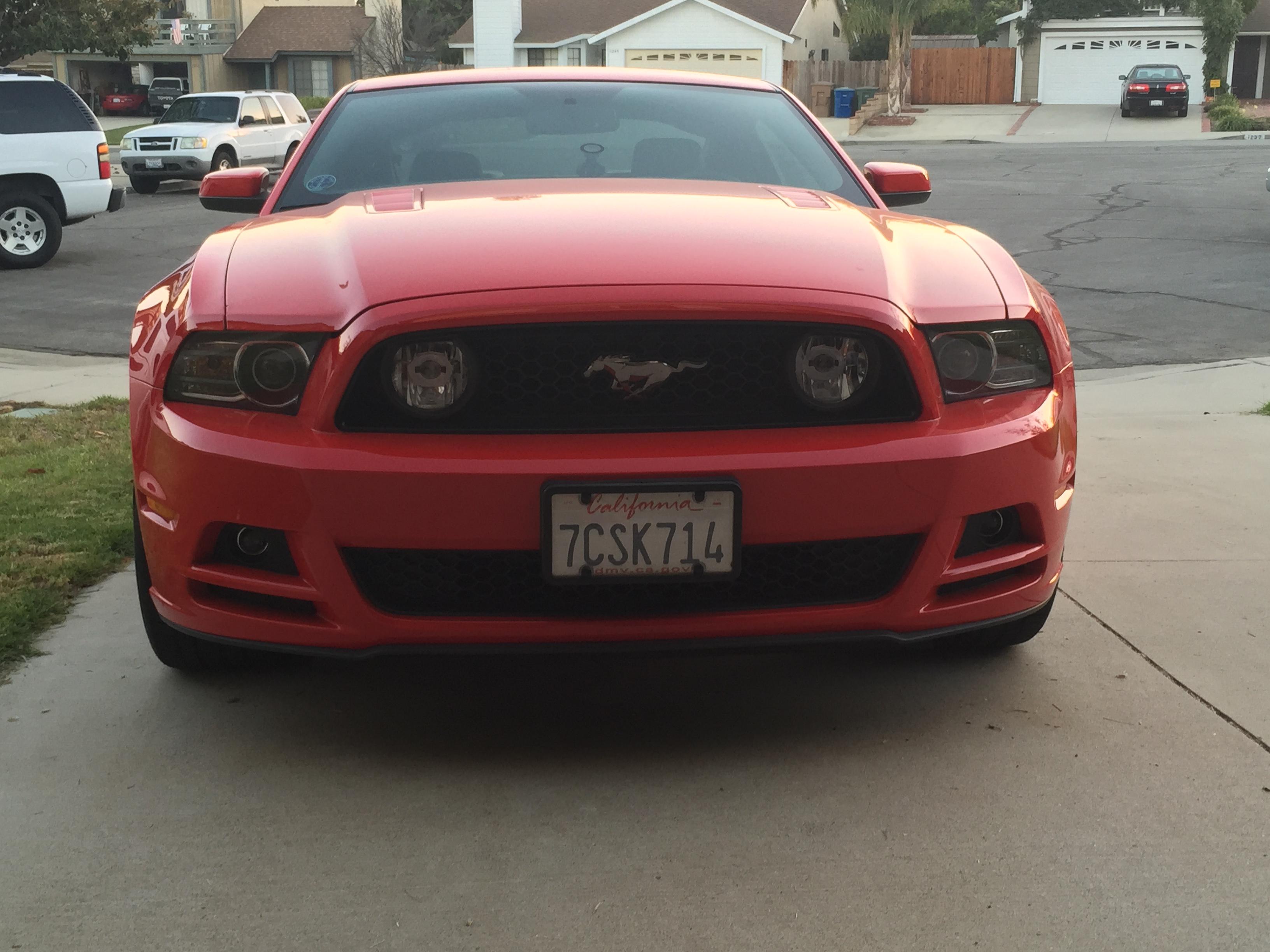

Yeah, I’m doing it. Just used one of the wires from the grill fogs to trigger a relay that connects the CS fogs to the battery.
