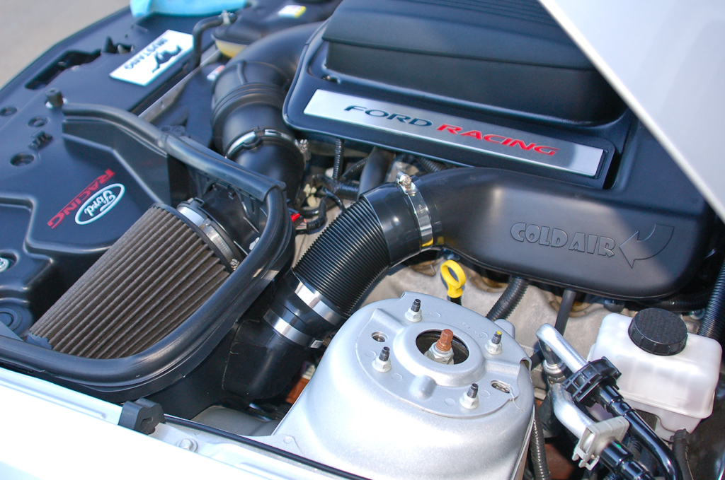

A few months ago I installed a CDC Shaker Hood. I have since then installed a Ford Racing CAI. The problem I had was how to connect the CDC Shaker cold air flow to the CAI. I searched the internet and many Mustang forums but found nothing. For those of you who have or might do this in the future here is how I did mine. Sorry there are no step by step pictures but I was in a hurry trying to get it done to go to a Cruise-In the next day.
This is what I came up with. Sorry but I don't have step by step photos. I was in a hurry to get it done for a cruise in tomorrow.
1st... I went to O'Reilly's and bought this for $20.00.
I then took the CDC part that goes into the original air box and cut it in half and used the bottom half that snaps into the air box.
I drilled a 3" hole into the CAI and inserted the part into the CAI.
I cut off about an inch of the cold air feed that comes from the CDC Shaker to give me some bending room. I cut the flex hose to length I purchased from O'Reilly's and then clamped everything down.
