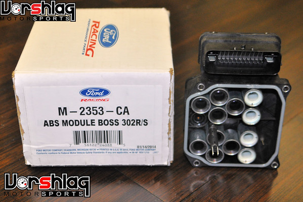

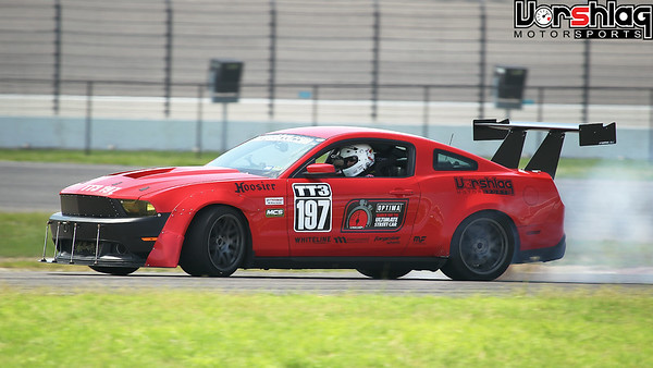

As Sky Render said it is more tuned for racing tires. When we moved from "DOT" 315 Hoosier A6 tires to 335F/345R A6 tires the AdvanvceTrac would go into fault mode and turn itself back on. Always.
Right after we switched our NASA TT3 setup to the "BIG" tires, and had all of the issues, we then quickly added the -CA version of the ABS module. All of the traction control system faults went away - because Traction Control was 100% disabled with this new unit. I didn't really see any need for "better" ABS action, and that wasn't why we did this mod.
But.... over the next 2 months months later I ran this car with the new ABS module at two street tire events. First was a Goodguys "All American Sunday" autocross, which I won handily, and the next was an Optima qualifier, which I also won. This was on 335mm BFG Rival tires (not the -S) and they have a LOT less grip than the Hoosier A6. Like a LOT less.
Over those first two weekends the car worked amazingly well on street tires - better than it EVER had before. Especially the Optima event's "speed stop", which is really just a glorified launch + ABS test. The car stopped better and more predictably than it ever had on street tires (we had run Optima events + SCCA STX & STU class autocrosses on 140-200 treadwear tires before in this car).
So while it was probably "designed" for race tires, the M-2353-CA ABS module does work on street tires (and if you ask me, it works damned well). If you can deal with the dash being lit up like Christmas and a loud "bonging" chime warning every 5 minutes or so. ;)
For these reasons (warning lights + chimes - as shown above) I don't suggest using this ABS module for street driven cars. But for a competition car? ALWAYS. Your results may vary. Don't eat any wooden nickels. Some swelling may occur. Call your doctor if an ere.... well, you get what I'm saying. "You were warned".
