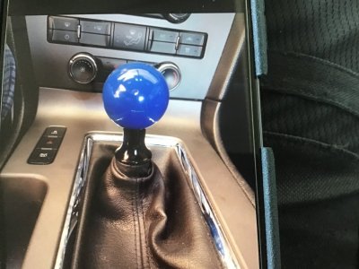

I did the Barton on my 09 GT and love it...
You didnt mention what year the car was, but judging from the fingers crossed comment, I am going to take that as having the early style heads. Take your time and hopefully all goes well.

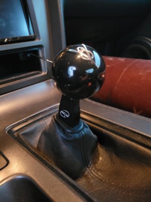

I've got a T5 in my '66 and was looking at their shifters for those transmissions, but I don't see a handle that would work. It needs to be swept back pretty far as the location coming out of the trans tunnel is quite far forward.
redfire - did you go from stock to MGW in the fox car? I have a steeda tri-ax in there now and wonder how much improvement it would be.

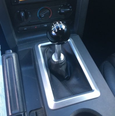

This is what a flat stick looks like, on an MT82 at least. THE best shifter, you'll be pleased with it. And like skwerl said, if there's something you want to change, call them up. Their customer service is top notch.
