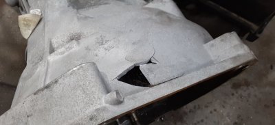

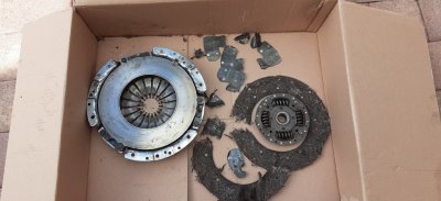

Hi I have an 14 gt 6 speed looking at clutches in case I need one in the near future. This is my first manual I've owned so be first clutch I'll have to purchase when I do so I don't know anything about them. Is exedy fmk1026 good for stock car with flowmaster outlaws as only mod? Thanks in advance!
My one experience with an Exedy stage 1 clutch on my stock 2011 stock GT Coyote. It blew up first time I downshifted from high rpm and put a piece of shrapnel through my bell housing. Exedy told me to stuff it when I complained. Buy from them at your own risk.
