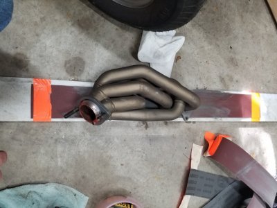

Heads look very flat. This piece of marble is what I'm using to true these up. If I'm not happy with the results I'll take them to a machine shop on monday. We shouldn't have to do this. Ignore all that red clay stuck to my block. i lived on a dirt road many years ago and it's still there.

Love your idea to use the marble for a flat surface. If you don't have any machinist marking dye, you can also just use a big permanent marker to color the face of the flange so you can see the high and low spots as you sand.
Looking forward to hearing that all your hard work paid off.

@moooosestang, a couple things. im sorry you had to go through all of this because of what a pain in the ass it is to install and remove these, but i cant thank you enough for posting your findings as it for sure has helped me, who is about to head down the exact same install path.
i would have never thought to check the square of the flanges, i still havent but will soon. and if they are in spec im lucky, but if they are all wonky i can address it before the install and save some money, time and headaches.

I was using the same setup to grind down the flanges. Sanding belt on a flat surface. Takes so much time. Glad I found a belt sander big enough for my headers. Saved so much time. Maybe check some local machine shops to grind them down. They’d have a much larger belt sander.

Yeah, it ain't quick. no machine shops open on the weekend and i'd really like to get this shit done.

What’s the length of the flanges? I measured the distance on belt sander at the middle of each roller and I’ve got 14.5” of flat surface. You might be able to fit it on a belt sander and since you’re only taking material off the middle, you’re not actually using the whole surface area of the belt sander. Also, wear gloves and a mask. There’s a lot of metal dust that you don’t want to breathe in or get all over your hands. Keep a vacuum handy too.

Duh! i think i can take the guards off and get it on my belt sander.
