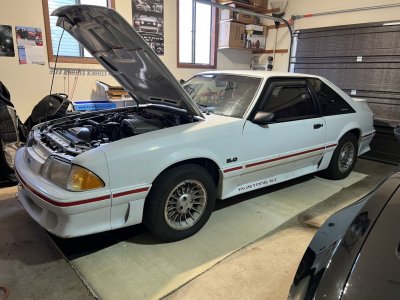

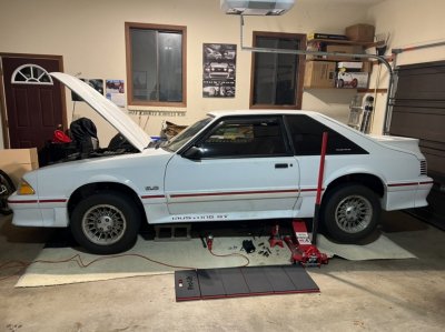

Upon further inspection, it looks like I've got an exhaust leak in addition to the oil leak that was not resolved by the RMS being replaced. I tried a quick fix on the exhaust hardware but it didn't do the trick so I'll have to get under the car for a closer look.
A couple of days ago , I did confirm that the car doesn't seem to be leaking significantly more oil than previously. It doesn't seem to be leaking oil at all while parked/not running. I checked the oil before and after taking it for a 20+ minute drive and it didn't seem to be significantly down.
I still didn't drive it too hard but the few times that I did give it a little more gas, the gears felt pretty good. I am hoping we'll get some slightly warmer weather sometime soon so I can spend a little bit of time in the garage getting a closer look at things underneath the car.

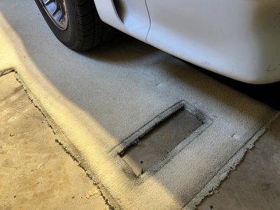

We recently had carpet replaced with hardwood floors in part of our house and I managed to keep a decent enough sized piece of carpet to give me some temporary padding/sort of insulation.

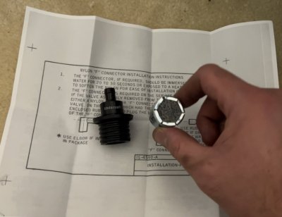

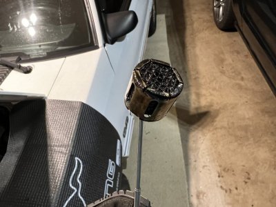

So I finally got behind the intake manifold and saw that the PCV valve was super loose. It seemed like it was still in the hose but was disconnected completely from the grommet and the grommet itself came out really easily. I was also able to remove the screen pretty easily with a magnet:
I replaced the screen, grommet, and PCV valve and everything new seemed to fit pretty decently. These are the new pieces:
It was pretty late when I finished it so I didn’t start the car yet but will do that today and see how the oil leak situation is looking. :) I didn’t take a ton of pics but recorded some of that process for my next video.

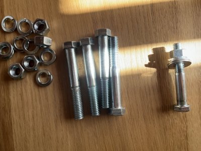

My latest attempt to get the exhaust leak sorted didn't work. I have not been able to get the hardware on the driver side to tighten down correctly so thanks to a recommendation from another Fox owner, I stopped by Tractor Supply and picked up some new hardware that hopefully will do the trick.
D20AB9B8-798F-4D57-84C1-350BE117D7CE.jpeg BA4AED3A-DC4C-443B-A7D7-5C1058C49C55.jpeg
I ordered a replacement hardware kit from LMR and the bolts are too narrow and too short. The bolt on the far right is one of the bolts from that kit. The others are what I picked up today. Will try to see if I can get this sorted out tomorrow, since the weather is supposed to be semi-decent.
