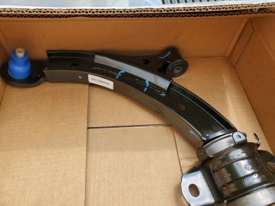

The front control arms on my 09 have been making terrible popping and clunking noises, and it's gotten worse over the past few months. I finally decided to replace them with the GT500 style control arms. Part number M3057E
On the Ford site, they look like this: https://performanceparts.ford.com/part/M-3075-E
I ordered the same part number from Amazon, but what I received looks a bit different. This is a photo of the ones I received: 20210724_120010.jpg
Notice that the 2nd mount is welded on instead of one piece.
Here's my question, was this a redesign of the previous model? The box is marked as being produced last month.

Those are in fact the GT-500 design. The ones you saw on the Ford site are GT version. Slightly different layout. They'll both fit just fine. Truth be known I'm not sure there's that much of a difference.

I got them installed yesterday. Fitment was fine. They are definitely a bit more beefy, but like you said, I'm not convinced it makes a huge difference.

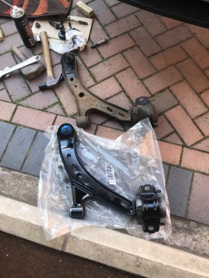

I ordered mine through rockauto and fitted them a couple of weeks ago. I would definatlely recomend getting the alinement done. Here in the UK we have the hawk system (not sure if same in the states) but it made a big difference. Cant really mees with the back wheels but the front were done.

Those look exactly like the ones I bought off of AM a little over a year ago.

Hmmm...Can you tell if the center section metal is the same thickness as the stock arm? Appears they welded in an extra plate and wondering the reason. If they're the same thickness in the center section then IMO actually a good idea as it should prevent any flexing. If thinner I'd be concerned.

That is a design change for strength and/or ease of fabrication. Very interesting. I see 3 versions here. I dont think my Ford racing/gt500 arms have 2-3 x the material and welding as these versions I see here.
